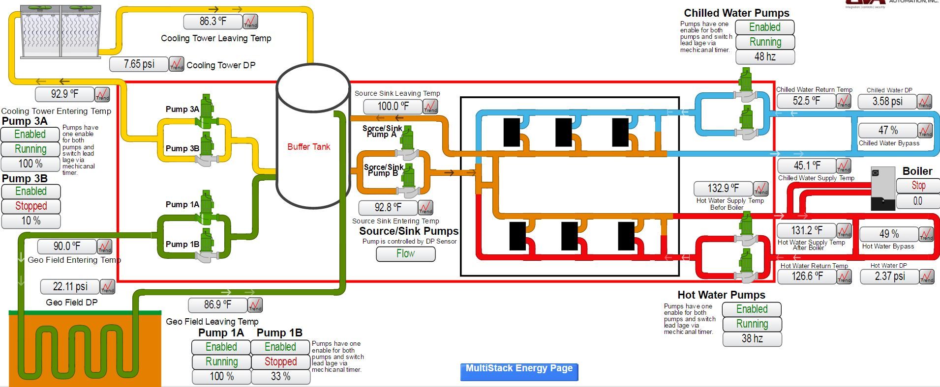

    I need someone to give me a rationale for piping a buffer tank as described below. From what I can tell, the system will never buffer unless the sink/source is off, and the tank is better described as a mix tank, or a massively oversized low loss header. I think the engineer that designed it made a mistake.
    The unit is a Multistack VME-II DHRC, 3 modules, 140 Tons total (50/50/40). Virtual endcaps after the 1st 40 ton module and after 3rd module.
    This unit is a little unique I'm told as the Sink Source pump does not directly feed the geo loop, instead with a buffer tank in between. Oddly, the fluid cooler return goes to the geo pump suction side, not the buffer tank. Here's the basic diagram (excuse the simple nature). The buffer tank is about 1000 gallon and approx. 12' tall. 4" connections.
    GEO Loop Return --> Top of Buffer tank
    Bottom Buffer Tank --> Geo Loop Pump (common header)
    Bottom of Buffer tank (common header with geo pump) --->Fluid Cooler Pump
    Fluid Cooler Return -->Geo Loop Pump (common header)
    Return from Chiller ---> Top of Buffer Tank
    Bottom of Buffer Tank --> Sink/Source Pump (to Chiller)
    So as you can see, the flows will always cross whether the unit is sinking or sourcing heat. The result is return temps to the chiller are 3-7 degree delta T of the geo loop return and, you need to double pump the water to utilize the fluid cooler. It can only cool the loop, not the tank directly, so there's some lost opportunities and wasted energy. The loop operates at 22psi delta P at design. The fluid cooler just 7 psi.
    The engineer that designed this I think had too much on his plate and simply missed some details. The Boiler for the system was piped backwards to the flow on the pipe AND on the return header to the chiller instead of the discharge.

    This is hard to follow the piping scheme using words.
    Draw a picture/schematic, and then I might be able to help.

    This is better.
    Note that the fluid cooler return is drawn incorrectly on this controls screen. It goes to the geo pump suction.

    Yes, the picture makes it way more clear. But it is piped more the way you drew it, or the way the control screen has it?
  10. #9
    Mixing oil and fire with a big spoon.
    8,082
    Your controls drawing looks like the way it should be piped. If it is piped like your hand drawing, someone is fooked.

    Quote Originally Posted by jayguy View Post
    It's piped like my drawing. Fluid cooler returns to the suction on the geo pump. The suction for both the FC & Geo are on a common header, single outlet on the bottom of the tank. Yup.
    I cant wait to see the engineer explain this. Supposedly the engineering manager used to work for Greensleeves that does the logic for the loop and fluid cooler pump control. The Multistack controls guy had to stare at the piping for like 10 minutes and was then like "Huh?" Why is it like this.
    Thanks for confirming what I thought.
