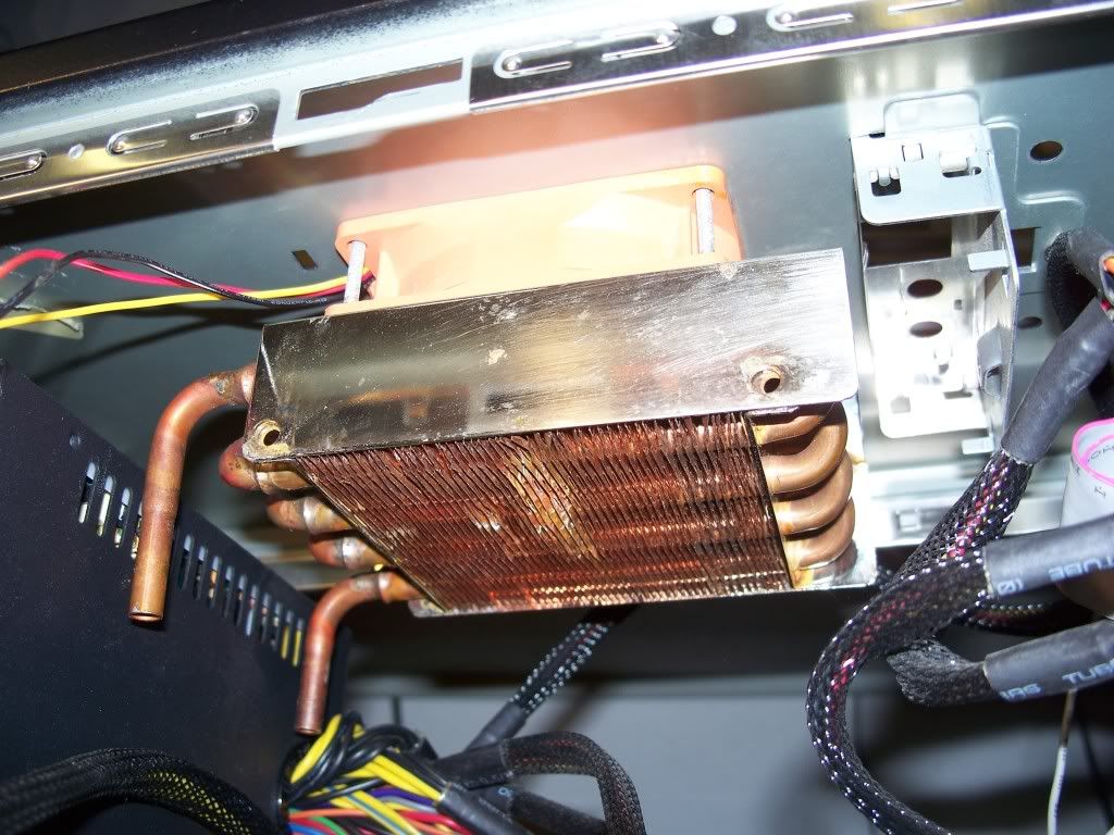

    I did made some progress, as I was able to remotely control compressor speed and all functions of the system via Arduino and PC serial interface. I made my own evaporator out of frustration, from a 80mm PC processor heatsink, by removing the heat pipes and replacing them with tubing. It didnt work so well, it didnt absorb much heat.
    I then finally got my hands on a small, full copper evaporator like this one:
    its 80x80mm and soldered it to the system. Also, in the process, i cut the capillary tube shorter.
    It worked really well. the first part of the evaporator ( about 1 inch of piping) would form a small frost and throw cold air.
    However I was left with a few thoughts:
    1) it would work really well at the beginning, it would get hot on condenser and cold on evaporator. after a few minutes, not so much. Maybe no enough heat to the system?
    2) at full power, the compressor would kind of "choke" or make banging sounds, kind of like compressing liquid. but there wasnt enough refrigerant in the system, or else the entire evaporator would have to freeze and flow upwards to go to the compressor. So i never ran it past 90% RPM limit.
    3) it developed a small leak. I could see about 1 drop of oil would form from the leak ( with UV dye). I tried fixing it but I could never do so. It leaked out and has been left to sit for 2 yrs, empty. Is the system ok? Do i need to flush it? is it ruined? I has never been opened, just lost its gas over time. Its been sitting in a room, indoors this whole time.
    Anyone who has comments on those 3 points, greatly appreciated.

    Can't help much without the basic measurements, like superheat subcooling and so forth. You should be able to vacuum it out after standing open, as long as you maintain low microns.

    That’s a water coil, not a refrigerant evaporator coil. What kind of metering device do you have?

    I'm going to guess it uses PAG oil. Should i vacuum it? should I heat the entire unit and then vacuum it? If i need to flush it, how do i flush the compressor?
    Quote Originally Posted by R123 View Post
    I have a capillary tube, of " Capillary Copper Tube ID * L(mm): 0.6*2.5 " but I have since cut it shorter.
    The evaporator is indeed a water coil, but its no different than a refrigerant coil, its positioned vertical, so the gas must flow upwards trough the coils. Its all i can get my hands on for now.

    Hello everyone, I have an update:
    So I managed to find the leak near the evaporator and now the system is tight. I also replaced the oil with ester, since other similar products use it too.
    I made an extended run, and I added refrigerant until I thought it was good enough. These are the specs I'm able to get.
    At Compressor MAX and Evap fan in medium air flow.
    High side pressure= 1Mpa (145 psi), 43C~(109F)
    High side out gas temp ( taken at end of dryer filter, where capillary begins) 100F
    Low side pressure= 0.35Mpa (50.7 psi), 12C~(53f)
    Low side out gas temp ( about 1 inch of pipe out of evap) 64.6F
    Ambient air=82F
    Air coming out of evap= 73~74.5F (Ignore heatsink next to Evap, it was not used to gather the data during the test)
    I believe my capillary is too short, something is not right. Anyone care to help?

    High side out gas temp ( taken at end of dryer filter, where capillary begins)???
    Low aide out gas temp???

    Well, if I'm not mistaken, to calculate "superheat" and "supercool" I have to measure these two temps. both coming in and out of evap and condenser, so that what I did. I began this project with 0 knowledge of A/C field so correct me if I'm wrong.
    I took my info from here:
    http://www.aprsupply.com/support/tec...-cooling-delta
