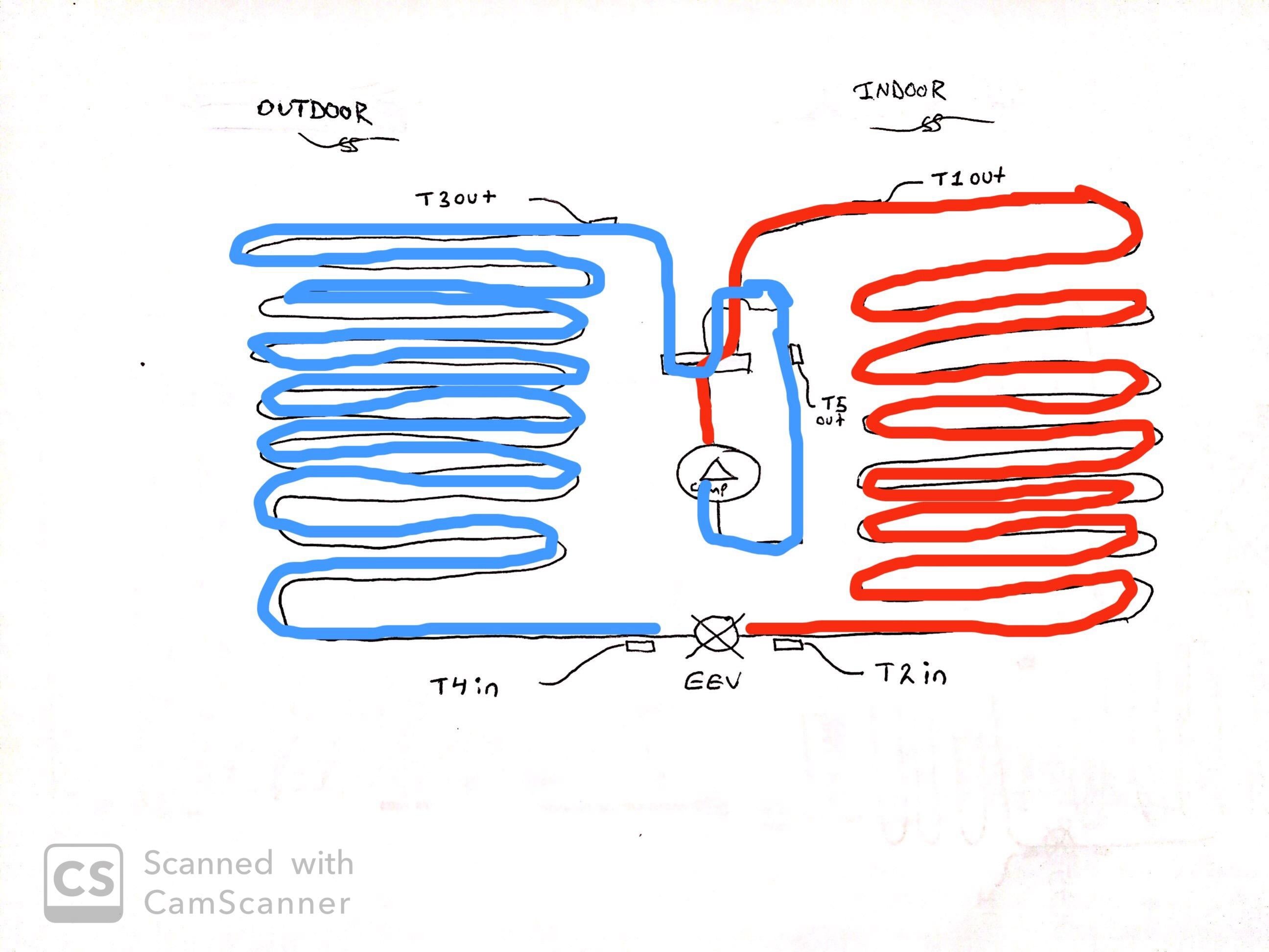

    Quote Originally Posted by thatguy View Post
    You could probably get away with making a HP using one EXV if you place temp sensors on both sides of it and after each coil, and operate the leaving side of the liquid line as a low pressure saturated line that leads to the evaporator. Isn’t this what typical ductless splits do? Hence the need to insulate both lines? If the EXV was placed in the condenser section then it would reduce noise inside at the AHU. Heating or cooling mode would simply select whatever inputs are required to control the EXV.
    Is this for a class project?
    Yes it is for a class training.
    Actually this is what I was thinking of, as the heating and cooling are a must.
    So I was thinking of making the same set up with same parts (2 temp sensors and only one EEV), because it will be complicated for me to change the orientation of the sensors (tell the controller which is the IN and which is the OUT for each mode) in case of refrigerant changing direction.
    I am taking the absolute value for the difference in temperature "|Tout - Tin|=Ts". So if the refrigerant flowed in the other direction it will still go through the same EEV and the EEV will still regulate the flow in the cycle, to maintain the 10 °F superheat.
    Am I right or not making any sense

    Quote Originally Posted by shamooooot View Post
    Not making sense... or I’m misunderstanding you...
    So you want to use one EEV and only two sensors total? I don’t see that working but I may be misunderstanding your idea. Let me explain how I visualized it working and let me know if it falls in line with your thoughts. Perhaps you could explain it in a similar method if your idea was different. Feel free to use proper coding language in your example. It would be good for me to see it anyway. It’s something I’ve wanted to learn just never had the time yet so have always resorted to modifying other code to suit my needs. I’ll do my best to respond using the proper language as we hash out ideas.
    Can you monitor the status of your reversing valve with a digital input? Let’s say the reversing valve inputs to DI1 for this example
    If DI1 = on, then follow program Cool
    If DI1 = off, then follow program Heat
    Program Cool =
    If |T1out - T2in|=10+, then open EEV
    If |T1out - T2in|=10-, then close EEV
    Program Heat =
    If |T3out - T4in|=10+, then open EEV
    If |T3out - T4in|=10-, then close EEV
    Now again, understand I don’t code, the actual code to run this would look different but I’m hopeful this example will work to explain my idea as to how I would see it working with 4 thermistors.
    The reason I don’t see only two thermistors working on a HP application is because when the refrigerant changes direction, the saturated side of the EEV where one of your thermistors is located now becomes the subcooled side. You can’t use the subcooled measurement to control superheat. (Well... Perhaps you can, I shouldn’t say never, but it would come with great difficulty and high cost. Unless there is a better way than I can think of then I don’t see it being very reliable and It would be prone to failure)
    You may be able to use only 3 thermistors if you put the evaporator leaving sensor on the true compressor suction line instead of the evaporator outlet. You would want to increase your superheat a bit. The response would be slower but you MAY be able to tweak out the hunting in the software.... but it also opens you up to other issues so it would come at a potentially high cost if it doesn’t work as planned.

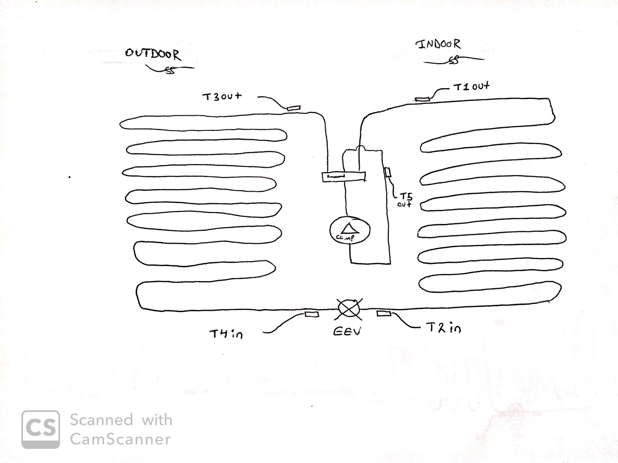

    I made a quick sketch ... sigh, I should label the sensors according to how we’ve previously discussed... I’ll draw a new one up when I get the chance.

    So if you were to use 4 thermistors then you would use T1, T2, T3, T4
    If you use only three thermistors then you would need T2, T4, T5

    Can you walk me through your sketch?, I am a bit confused with it.
    The outdoor unit has its own system and its own expansion valve. Is it safe to say that I can use the T1out and the T2in only, as my inputs ?
    Thank you for all your efforts!
    Does this help?
    I drew it in heating mode because I mentioned previously in my example that Reversing valve input would be heat when Unenergized.
    Simply swap the hot gas out and the suction in through the reversing valve to change to cooling mode. I had drawn the little slider inside of it to indicate the path of the suction gas on the first picture. That slider is true to life as to how they work. Slide that over to connect the middle and right pipes (instead of the middle and left pipes) and you will be in cooling mode.
    You will see that your thermistor is not in the right spot to measure superheat when you switch to cooling mode so if you want both heat and cooling then you need to add at least one more thermistor. So you can monitor the refrigerant temperature at the outlet of the EEV after the refrigerant changes direction.
    Let me know if you still have questions.

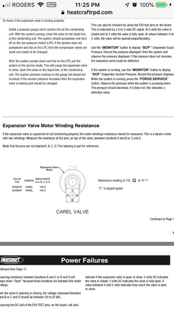

    We install walk in freezer and coolers that use a 5V DC EEV, the EEV will open proportionally to the strength of the signal between 0 and 5V, if they all are like that then an Arduino would be perfect for them
    https://www.heatcraftrpd.com/QRC/res/pdf/H-IM-QRC.pdf
    thats the link to the manual for the control module, should help you get an understanding of how to program the arduino at least on the cooling side, it has part numbers for the EEVs/sensors towards the end you could probably find a manual on those or something similar but for heat pumps that will help you get a base for what parameters you are going to want to use

    Quote Originally Posted by KittySwampAss View Post
    Hmm interesting so there's no stepper motor power head on those eev's? Do you have a pic of the eev?

    Quote Originally Posted by JayMan7 View Post
    Sent from my SM-G960U using Tapatalk
    It sounds to me like it is a control board that has a 0-5v DC signal input from the pressure transducer , the control board converts that to a equivalent number of steps output to the EEV.
    “The expansion valve position can be monitored from the LED display pressing the “MONITOR” button and scrolling to ESP. This will indicate the number of steps the valve is open.
    This can also be checked by using the EXV test pins on the board. This is indicated by a 0 to 5 volts DC signal. At 0 volts the valve is closed and at 5 volts the valve is fully open. At values between 0 and 5 volts, the valve will be opened proportionately.”
    It says it’s a “bipolar motor with two windings” controlling the EEV.... sounds like a stepper to me.
    I haven’t read the whole thing, just skimmed some parts of the manual hat looked like it would include this info, so I may have missed something here but looks like a normal stepper to me, however it also looks fairly easily replicated with some programming and an Arduino

    True 0-5VDC would make more sense as a signal circuit and not as the actual driver of the eev
