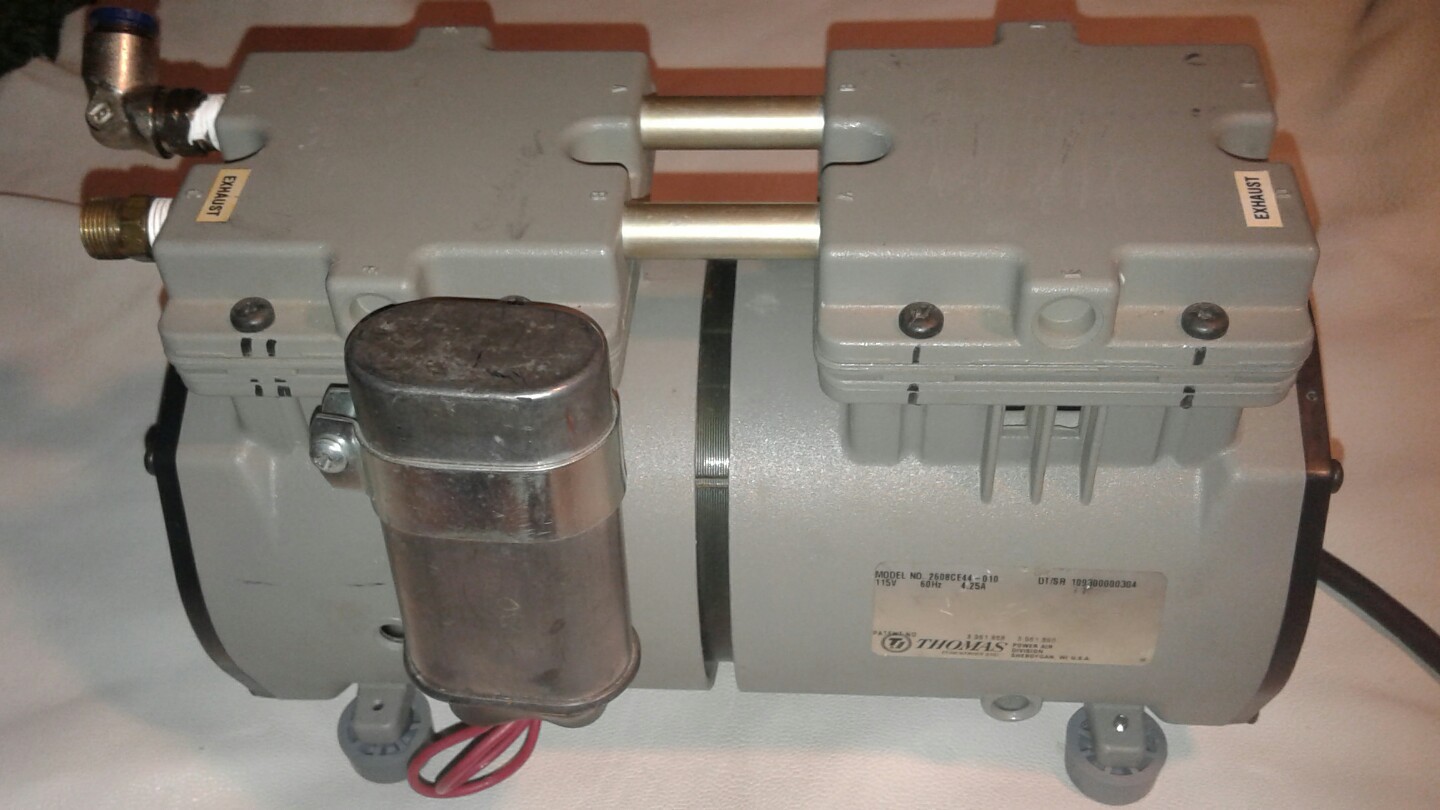

    Next time Im at dad's Ill get pics of the setup. we used a piston pump rather than a vaned/oiled pump. Like this Thomas pump:

    Quote Originally Posted by HVAC_Marc View Post
    Ooo, I can get my hands on some used chiller purge pumps. They are diaphragm style with reed valves like yours. It's a single stage though. Might take a while but it does pull down to 15"Hg
