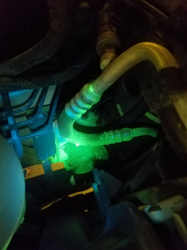

    Are these systems to be weight in? Is recovering, charging, evacuating all the same as a residential system? I'm thinking mine has a leak. Oil and some yellowish greenish tint on some hoses. Thinking someone put dye in?

    You do weigh in, to the Oz, and yes, that's dye.

    Timebuilder, do you happen to know if these hoses/lines are a common leak or is there a seal of some sort at the connection? Was thinking about just replacing the entire line or lines?
