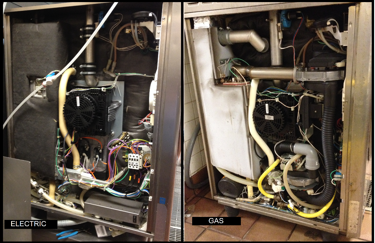

    It would CERTAINLY be allot simpler. Here's some photos of two of our SCC101 ovens I put together awhile back to illustrate JUST that:
    The ELECTRIC: Looking all simple, neat and tidy. There's SO-O-O much LESS going on in the electric oven.
    The GAS: A maze of what runs through where so as to not leave it to be scrunched when you BANG the side panel back on.
    I still want to ask why they left a cubic foot of NOTHING up there above the steam burner flute. CERTAINLY they coulda put something THERE TOO!

    Well, never mind that. That electric one is even a little simpler than newer ones for it also being an original version D oven. So it's missing things like the the care pump, care valve (no triple valve) and the care drawer.

    I'm interested in (JUST) observing the installation of a combi-duo set of ovens by you PROFESSIONALS.
    Dealing with that TOP oven was a nightmare. Too many expensive things sticking out the bottom of it. And with no legs on it, there's not any options once you pick it up...other than nestling it carefully BACK down into a SPECIAL, factory-made place.
    That was one of my challenges. I needed the top oven OFF, but you can't just set it down on a bench or on the ground. No legs. I also needed to keep it mobile (we be busy).
    So I cut & bolted together some hefty angle-iron to form a cradle. Beings it was at our shop (instead of in the kitchen)...and we have a loading dock and a fork lift, I installed legs onto that homemade cradle, got the oven up, then set it down into four of those three-castered, funnel-like, cup-shaped dolly thingies. Well...DOLLIES (WHAT do you call those?). That worked very well to accomplish what I needed and then perch it back up to its new post once the bottom oven was ready for it.

    DONE.
    Had it perched on its stand last Sunday and worked on it through the week.
    Got it back into the kitchen yesterday morning:

    It must be an amazing feeling after having had it to such little bits and then successfully back together and working.
    I know I would be rather chuffed if I had done it.

    PHM, I always enjoy your posts. Some of your better stories should be in a book. Maybe "The Poodle Head Mikey Chronicals", or something along that idea. The one you posted a year or so ago about you being out running calls and your urge to do the #2 led to your getting caught by the woman looking out a window at you in your "chosen" territory - behind that seemingly remote and secluded bush. I think you said you slipped and fell in it? Can't remember, but I laughed my a$$ off! You hijacked that thread!
    Your talent with words is exceptional. So NOW you throw "CHUFFED" at me. I might be the only person who's never heard that word, so I had to look it up.
    YUP. THAT'S an apt description.
    I came up with a BUNCH of other words for what I had to do to this oven. There's probably more I could add, but here goes - in no particular order:
    I contemplated, eyeballed, researched, dreamed about, sought options/resources, sought out materials/went shopping, forklifted, heated with torch, pried, hammered, drilled, tapped threads, measured, X-acto-knife cut, plasma cut, band saw cut, cut with grinder, filed, degreased, MIG welded, plastic welded (we have a kit for that), used a grinder/wire wheel, sanded, degreased again, primed, painted, eliminated pesky insects, disassembled, sorted, organized, pressure washed, washed in buckets, cleaned with solvents, scrubbed with scrubby pads, scraped with razor blades, polished, vacuumed, reassembled, cut with pipe cutter, soldered pipe, troubleshot, repaired wiring, replaced many expensive parts, updated software, calibrated and…worked MUCH overtime.
    My best guess is about 100 hours of dedicated time on it. So making the little video was having a little fun on my own time and to put the cherry on top - in commemoration that it's DONE! I went to work today SO relieved that I could do OTHER things.
