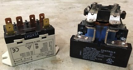

    Up until recently, here were the choice of contactors that power that element:
    The left-hand one is rated to 25 amp. The right-hand is rate at 30 amps. Note their difference in size and design. The left one has much smaller contact points in it (not visible in this picture) and a much weaker return spring than to right one has (which BOTH are visible).
    Up until sometime in 2010 (or maybe later), both of these contactors were listed in the parts manual and available as replacement parts. The manual distinguished which one to use based upon the serial number of the machine.
    HERE'S THE REALLY IMPORTANT PART:
    That contactor on the LEFT (which, to ME...only qualifies as just a relay), can stick CLOSED. If it does, then the element remains energized DESPITE the thermostat -OR- DESPITE the FILL switch - which serves as the power switch for the machine. There is NO redundant hi-limit thermostat circuit to disable the element in the event of a main operating circuit failure. So...all that stands between the 4 kw element and a 208v power source is that contactor.
    Why am I sharing this?
    There's eleven of these units on the property I work at. Since 2012, four of these units went into a runaway heat mode. Two were caught by the user. They called them in and we in our kitchen maintenance shop came to the rescue.
    The other two? One self-destructed. The water boiled off, then the machine's innards melted down (curtains, wiring, anything plastic). Nothing was on top of the unit or in proximity to it that caused anything else to be damaged.
    The latest wasn't so sublime. The event ended up being videoed by the security cameras. Nobody around. Employees had all gone home. The washer glowed RED from within and caught fire at around 2am. The glass washer so happened to have those black rubbery, stand-off-like drying mats on top of its canopy -with clean glasses set upon them to air dry. Those rubber mats caught fire.
    It could've been worse. Thankfully it wasn't. The fire was just a few feet high. Lotsa smoke damage to the ceiling. Nearby stuff (the bar, nearby fountain lines, etc.) got damaged.
    The venue was closed for a week while a restoration company was contracted to come and do their thing. Our in-house guys worked their magic (carpenters and painters) by repairing the damaged bar, ceiling and got everything freshened back up again.
    AND...SO - WHAT TO DO with this:
    Well THANKFULLY, that substandard contactor can't be gotten any longer thru Glastender. Miraculously, it's disappeared as an available replacement part for their machines anywhere on the internet. Only the right-hand contactor in the picture is available - albeit, by using a newer part number than what's in a 2010 parts manual.
    Otherwise...if that left-hand contactor is collecting dust on your truck or on a warehouse shelf, get rid of it. If your company remains up-to-date on parts stock, that's probably not a problem.
    If that contacot is still at work inside of a unit somewhere, therein lies the problem.
    If you're a technician and happen to be called to work on a GT-24 or GT30 and your eagle-eyes spy upon a rectangular & enclosed grayish relay in there for energizing the heating element, INSIST to your customer that it needs replaced IMMEDIATELY.
    If you're an owner/operator/employee and happen to have one of these machine, then I strongly urge you to call a service company to have it checked out. Show them a copy of this post.
    NOTE: There's NO inherent defect with that actual relay (YES...I'm calling it a relay now). Its manufacturer makes good stuff and that relay can probably still be purchased for other applications. However, it's simply not suited for how it was employed within this glass washer...which is evident now that somebody who designed the machine has figured that out.
    FYI: This only applies to the GT-24 and GT-30 models.
    The GT-18 and the GW24 models don't have a heating element. Those units are fine machines. Well made and reliable. For that matter, we'd just purchased four of those units within the past year since we found them far superior to a competitor's model that we needed to replace.
    The GT-24/30 units are also good machines - with this ONE major exception that I've outlined here in this post.
