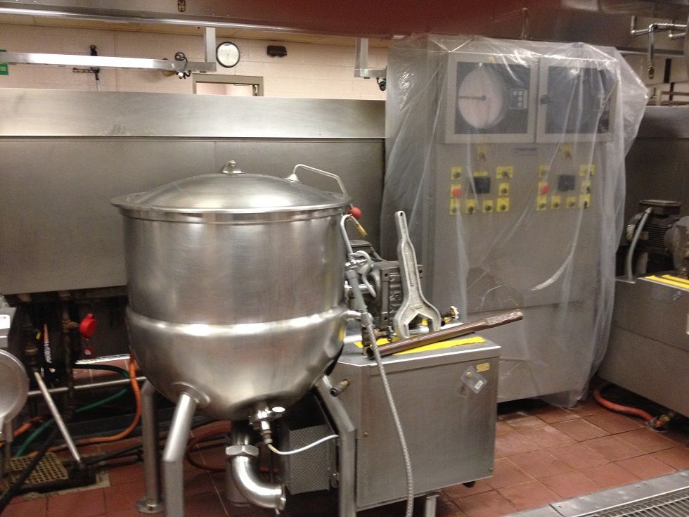

    This is a 60 quart steam-jacketed kettle that so happens to have numerous other add-on features. As a reference for its size, the control center next to it (with the chart plotter & switches) is six feet tall.
    This kettle’s heating medium is live steam. It’s rated for up to 50 psi of incoming steam pressure. 35 psi is preferred and is what a PRV feeds it. A safety relief valve is mounted to an appropriate port in the kettle’s steam jacket and will blow off if 50 psi is exceeded.
    This building's boiler sustains a constant 90 psi and a PRV establishes the desired operating pressure to the kettle:

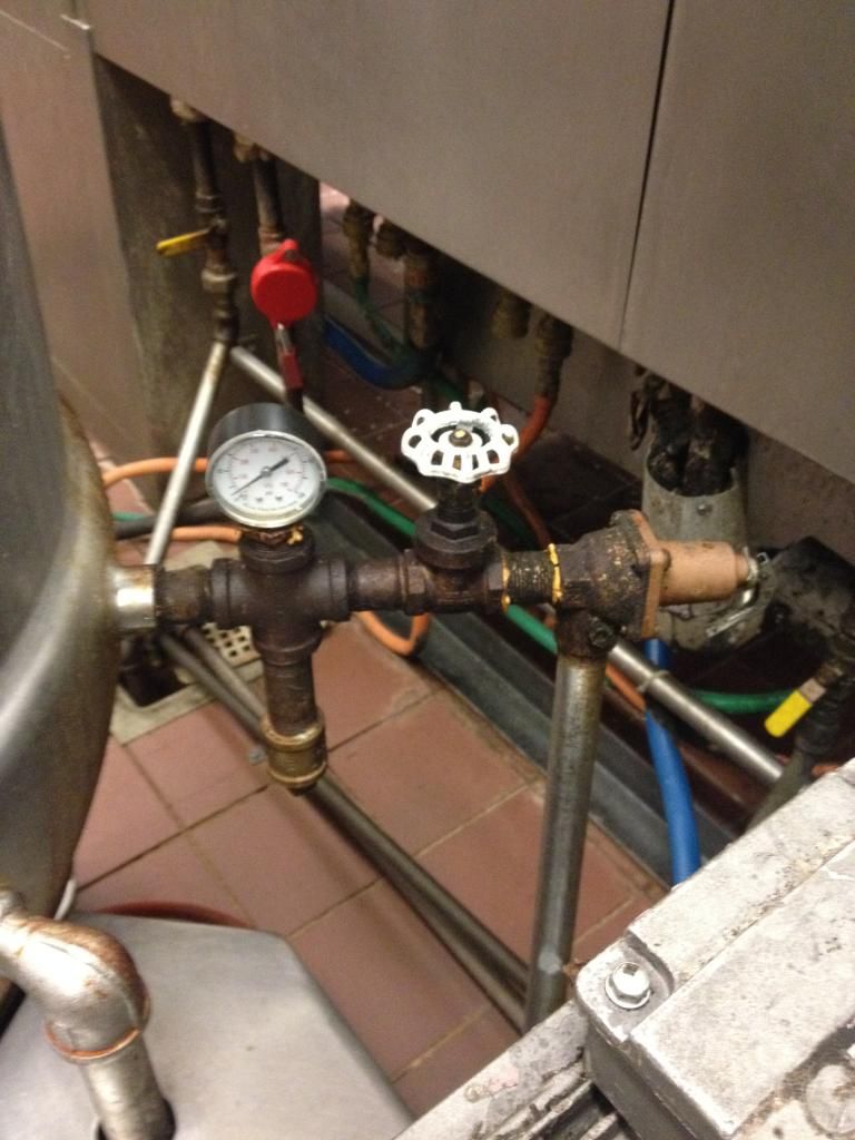

    THIS monstrosity is some modifications someone had made to the installation of this kettle’s safety relief valve installation:
    That gate valve was V-E-R-Y accessible to the users of this kettle - with someone who would've eventually thought it needed turning if the kettle wasn't working right. WHY someone installed it is beyond me.
    The pressure gauge is gone too. Being RIGHT THERE and with no protection (and no loop or dedicated valve), it was in too vulnerable of a location and prone to failure.

    I know what you're talking about. I saw it all during a brief tenure on mess duty. Never thought I'd be working on it someday.
    That one's a Cook/Chill with a mixer and a pumper connection. The smallest of four. Cook it, chill it, bag it in measured portions, seal it and freeze it if necessary. It all gets delivered to numerous restaurants.

    Very lucky people. Was the valve turned off? If so, that thing was a ticking time bomb.

    No...thankfully.
    It DID so happen that we had steam pressure issues just a few weeks thereafter. A PRV in the ceiling locked down, so all the kettle line lost its required steam feed. They didn't have a replacement, so they METERED the steam to the line with a another valve up there. The OTHER kettles are rated to 100 psi. The boiler system is set to 90 psi. This kettle is the bastard of the group, which is the reason I've made sure it has a point-of-use PRV that's in tip-top shape.
    So of course, my major concern here would've been if TOO much pressure were fed there by just such a circumstance. The safety is there for a reason, and this one could've been too easily circumvented by someone unknowingly turning that knob off.

    Are you replacing all that black iron and taking out the valve?

    Oh that's all long gone. Just the safety valve on it now - just like it was from the factory.
