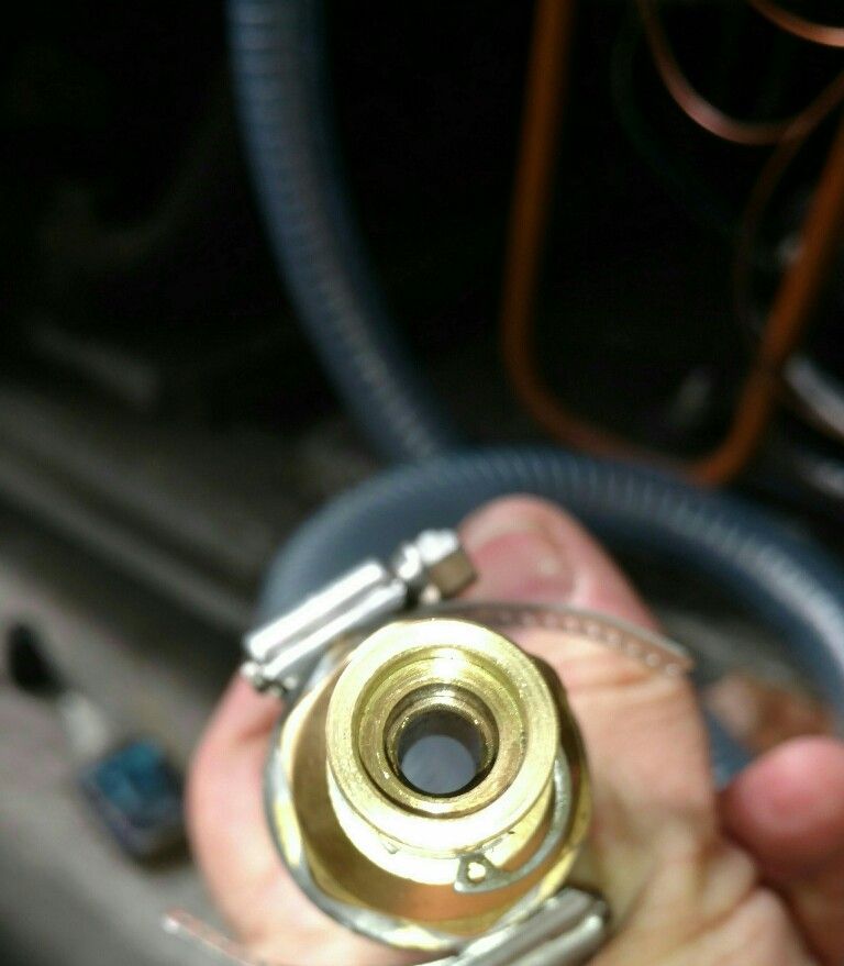

    It's faster for any size units. I use these on systems that hold ozs.

    Those are bad azz. Do you have a post on here about how to make those? I've search a little off my phone but haven't found like a full process on them. Thanks

    Had to replace a worn gasket. Here's without the gasket or knurled cap.
