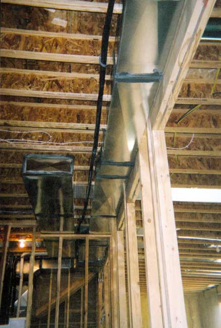

    Here's one example of what our duct typically looks like with a situation like you have.

    Is that 9" deep supply or do you hang your supply tight to the floor joist? It looks like the mech room wall framing is tight to both ducts. I like the plenum. Also is that cardboard panning? I've started using it recently. I don't like the look of it but... I'm sick of complaints about panning pops.
    [Edited by wally01 on 01-24-2006 at 07:41 PM]
    That supply is 8" deep (so is the return). We don't hang real tight to the floor, but pretty close. I always try to leave 1/8-1/4" below the joists. Doesn't happen very often but if the floor moves a tiny little bit it can make the duct work squeek or bong. I think the framing is pretty close to tight to the duct, infact the duct might even be sitting on it I can't remember (these houses turn into a blur, we do too many).
    Yup, thats the cardboard panning. I hate it with a passion, I think all returns should have a boot stuck to them and piped back to the return trunk. But in the real world there's no way we could get anyone to pay the extra to do this. I guess it doesn't look horrible, but I started in commercial, so panning was a bad word. Same with tape, we pookied everything. Now we pookie the duct and tape the pipe... when in rome I guess...
