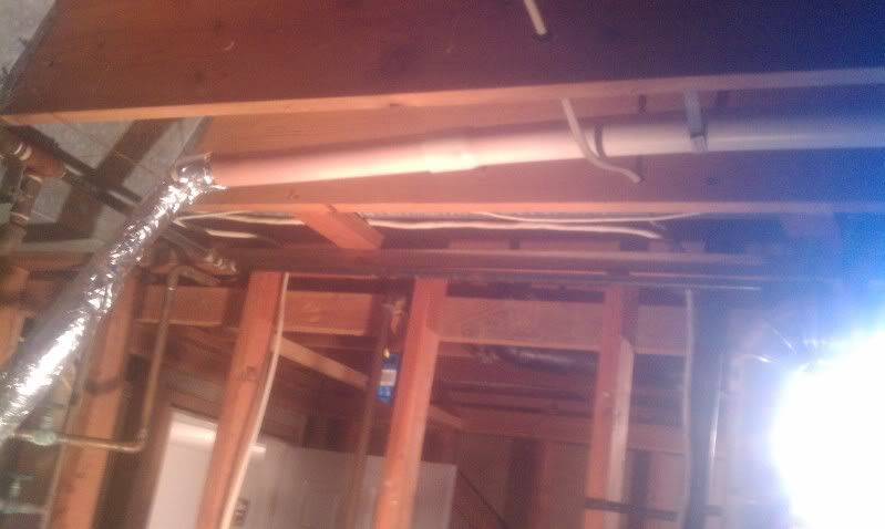

    how to horizontally vent a natural draft water heater in pvc
    I submit for your viewing pleasure a new method for venting your natural draft water heater in 2" pvc. Don't worry about your slope because after a while it will create its own slope back to the water heater.
    Also feel free to tie your vent for your 90+ efficient furnace into the vent stack for the sewer line. Also done by the same builder on the same house.

    Yep. Did a late install last night, did the furnace, red tagged and shut down the water heater, then went back today and did a fan assisted horizontal vent kit for the water heater. You could see the exhaust dumping out from the draft hood. The sad thing was for some reason the house was built like that too in the 70's(had absolutely no main stack whatsoevs,er anywhere). And that's a 3-4 yr old water heater. And there were other company stickers all over the place.
    7,152
    probably was electric and someone changed it, if no proper venting exists.
    I do not see a unit being improper for that long vented in PVC, maybe if it was metal.

    Last week I found a power vent WH vented in b-vent 40' horizontally instead of in PVC. HO didn't seem nearly as worried as I was.

    By "Horizontal Vent Kit" I assume you mean a power vent on the side of the house? I mean, that's the only acceptable means of venting a Category I appliance, absent a chimney. At least the codes we use say that.

    Can you furnish the model WH, the model horizonal vent kit and clarify what material you used for the 'corrected' venting?
