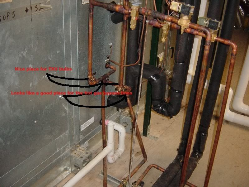

    How not to pipe in a unit
    The contractor was tossed off the job, I wonder why?

    i like the way the solenoids are wired oh thats over rated just turn it off right i think i seen this unit in dallas once thought i fixed it oh must be the same installing contractor job security for us i love it never know what tomorrow bring thats why i stay in this buidness

    Hey...with the right pressures, you might get it to play the Hurdy Gurdy...

    So much wrong there i cant wrap my head around it...Me thinks the bottom coils be full of oil.. I like the txv bulbs on the evap inlets on a vertical right beside the hgbp tee... wtf... did it run?? lol

    Betcha they nitrogen purged

    Wow im new to the field and to me that looks terrible. Wouldn't want my name on that what so ever!!!

    What!! No 45's ??? I like piping on the floor right under the disconnect. Also I'd really like to see PVC drains on commercial work outlawed.

    Biggest question Who was the commisioning company.
