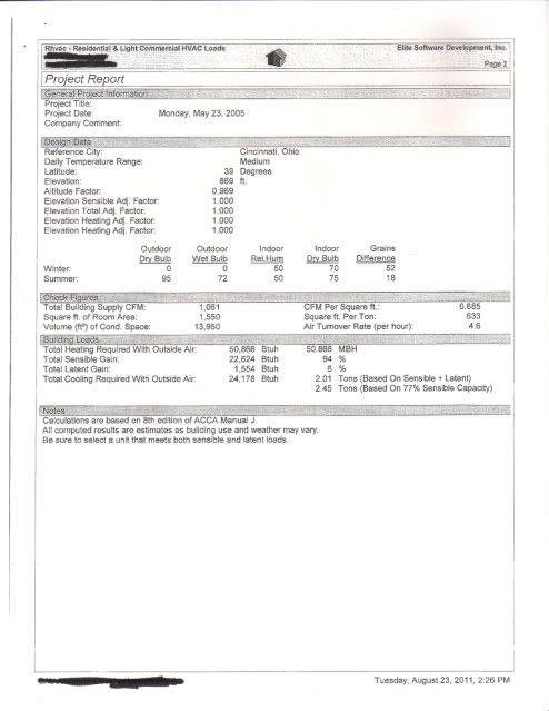

    OK, so I was able to take advantage of a program that the city has going on to do Home Energy Audits on homes to help save energy. The company came out and did the audit along with a blower door test. My biggest problems we air leakage coming from my pull down stair case, whole house attic fan and some air leaks near the rim joist on my house. The blower door test results were: 0.64 ACH at -50 Pascal with the house drawing 3652 CFM. They had the total sqf of the house being 2308 (1500 1st floor). They said I should be down near 0.40 ACH.
    When I called them to ask questions about the audit I asked if they did a manual “J” as well and they said yes. Looking over the report it looks as if a 2.5Ton unit is what it calls for but when the guy came to do the audit he didn’t measure any windows/doors and said he had the sqf of the house already. I showed him a drawing I had done that has all the room dimensions as well as window and door and he took a photo of it with his camera. So, I’m not sure looking over the report if you can tell if they used my info or just did a quick whole house manual J.
    I did this to find out what leaks if any my house had so I can fix them and to find out what size HVAC should be used. Currently the house (ranch 1500sqf 1st floor) has a 16yr old Bryant 90PlusI 80KBTU with a 3Ton AC. The AC unit leaks but not bad that we have to charge it once a year. They gave me quotes for both a Bryant Hybrid HP and Water Furnace GEO system. I was surprised that the HP was only $3K less than the Geo once all the tax/rebate stuff was off. Still, the HP quote was close to $4K more than quotes I had last year when we first moved into the house. I also wanted a quote to just replace the AC but I did not get that and after seeing the prices for the other stuff I’m sure it would be too much.
    Can anyone give me any feedback on my blower door results and what you make of the manual J report?

    I guess I'm curious to know how high my leakage is to other homes and how much this is going to effect my HVAC performance once it is tightened up?
    The leaks in the basement along the rim joist are going to have to wait until I get a bathroom remodeled. I have a drop ceiling but don't want to tear apart the basement yet. I would rather do a whole remodel at the same time of the basement.
    Was also wondering how the manual j results would change with the leaks being taken care of? If we got the ACH down to 0.40 could that lower the AC down to 2.0Ton unit?

    whoe did the manual J? did they measure your current insulation R-values? he may have left some things off the reports that they show you, but I see no load summary from window loss and gain etc. It apears to have been a minimal attempt at the load calc.
    you also state 1500ft 1st floor, I hope you do not have 1 system for 2 floors because it's not on this load calc.

    The same company that did the energy audit did the manual J, they do HVAC work and home energy type work.
    Its a ranch house with only one system. The guy that did the energy audit took my house dimension info from me (actually took a picture with his camera) but also said before I gave that to him that he has all the info needed for the manual J to be done. That's why I'm wondering if they did a quick one using just the size of the house.

    2 types of load calc. 1- block load and 2- room by room, both are going to need window,door and insulation info. Block load is aceptable to make sure tonnage is right, room by room is needed for airflow calculations.
    the load calculation he has done is basically for a normally sealed home. He is not showing you what the leaks you have add, help or hurt your calculations, through infiltration.

    This load calc you show say's it was done in 2005

    I saw that too but the correct date is down at the bottom of the page. I don't know if that was a generic entry they used?

    Teddkidd, Udarrel, PSTU or anyone else familure with Energy Audits or Manual J's can you tell me anything from the numbers I have posted? Not sure if the ACH is normal, High ect and what can be said about the results from my manual J. Does it appear to be a quick run through or did they just not give me all the info ect.

    unless orientation, size of overhangs,
    degree of shading, window type and size were
    taken your numbers are off.
    a picture of a house has never given me
    the info I need to do an energy rating.
    I need to draw the house or have a set of plans.
    specific inputs are needed to audit a specific house.
    insulation levels & areas minimally or not insulated.
    duct location, insulation and leakage values.
    for your size house the target leakage in cfm would
    be close to sq ft. more than this is still leaky,
    tighter would need fresh air.

    energy_rater_La, they had all that info because I told the guy who did the audit to take it. At first he said that he had all the info needed for the guy back at their shop to do the J but when I mentioned window sizes, door sizes orientation of the house that’s when he asked to see the drawing I had made.
    So your saying I should be somewhere around 2300CFM as a target leakage for my house then? Is the amount of leakage hurting my AC system allot. I know if it were tighter I would be more efficient but is my current ACH that bad?

    sorry I missed that...thought he has just taken a pic of the house.
    not gotten your information.
    target from my experience is roughly equal to sq ft.
    not tight enough to need fresh air, not loose enough to
    be heating & cooling great outdoors.
    the happy medium..
    this will put you around the .40 ach they mention.
    at .64 you can do a lot of sealing without worry
    of making the house too tight.
    the leakage at the attic access brings attic temps into the house.
    costs you more to heat and cool.
    things like attic tents that fit over staircases & hatches
    are stapled and caulked and provide an air seal and insulating
    value work well. http://www.attictent.com/
    I've tested quite a few of these, as long as they are caulked in place
    they seal well. just wish they had more R-value.
    foam for the rim joist.
    find the pocket doors in the attic and you will be able to
    see into the wall area above the door. it is only the door casing
    that is providing any type of seal. closing up this thermal bypass
    will help.
    did they test the ducts & return air for leakage?
    you could have a good amount of duct leakage,
    this is very common.
    best of luck
