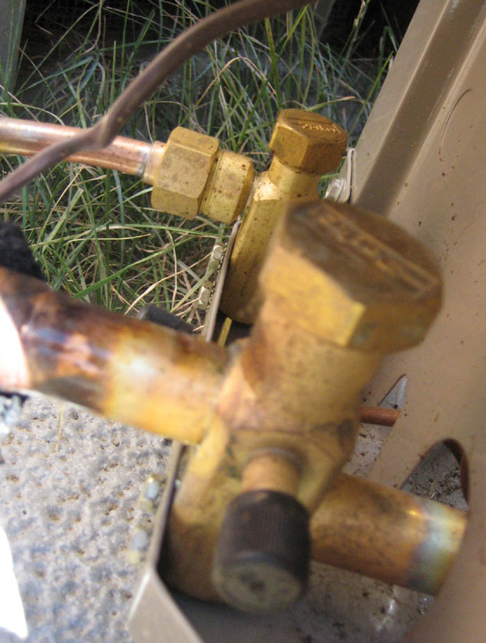

    Thanks so far... So is there no metering device on the outdoor unit? Indoor is a cased coil CNPHP3617 which says it has a TXV. What does the metering when in heat mode, the TXV on the inside coil still?

    If you look at the lines going into the outside unit you will see a small line and a bigger one. The smaller one brazes in just like the big one, but notice there is a nut at the end of the smaller line? Inside that area there is whats called a piston orifice, in cooling mode it moves very slightly in one direction and allows unrestricted refrigerant flow around it to your indoor TXV, in heating mode it goes the other direction and seats inside its holder and only allows refrigerant to flow through a hole in the center of it and that causes the pressure drop needed to operate in heat mode. I hope the Mods don't kill me for giving that much info.

    Aha, got it. Having read about a piston on this site over and over I just always imagined it to be bigger and easier to spot (like a TXV is pretty easy to find!) Makes sense, so it's in here right where the liquid line connects to the outdoor unit.
    Thanks for the details, I promise I'm not ripping this thing apart, just like to know how things work. Wish I'd studied more before buying it, but hey, it works.
    Is there some justification for using a TXV on the indoor coil and yet a piston on the outdoor on this heat pump? Obviously this is a lower-end 13 SEER setup and it's cheaper to only have 1 TXV, but how do they decide on which side to use which device? I'm in Oregon, this will probably be running in heating mode 90% of the time and cooling in 10%, and yet I have the fancy txv only in cooling...

    With the reliability of TXVs these days, be glad you only have 1!!!
    My Tappan is 14 SEER with variable speed and it is the same way, TXV in and piston out. Has an accumulator to protect the compressor. I'd rather have it that way than TXV and no accumulator.
