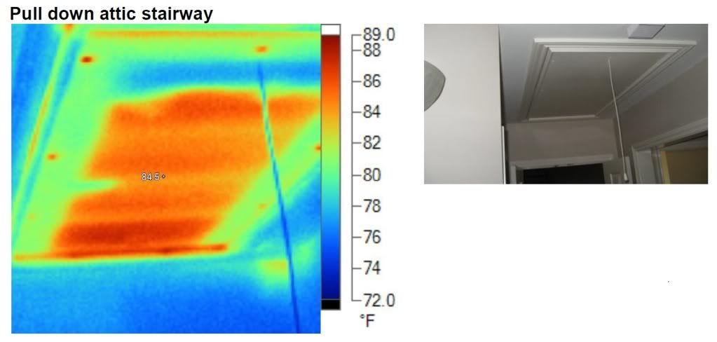

    Here's another pic of some ducting issues and other stuff.
