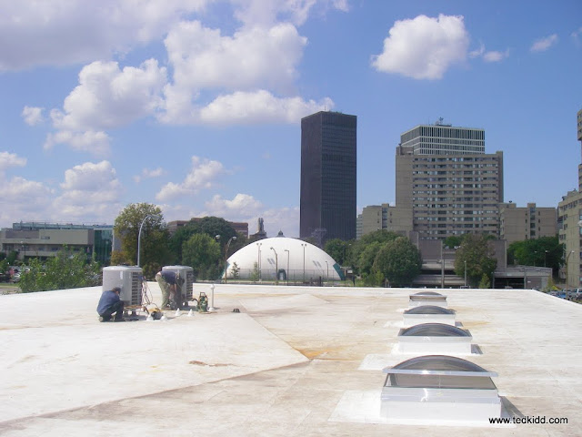

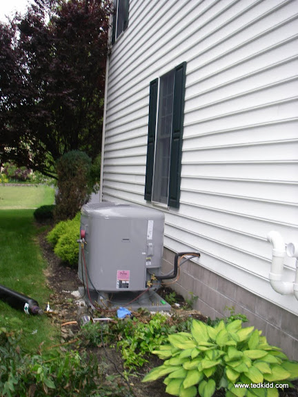

    All I ever sell is heat pumps, never sold AC.
    Every customer I've sold a heat pump to has Natural Gas.
    Here are a pictures of some heatpumps I've sold around Rochester:
    Let's start with my Mother's in Penfield:
