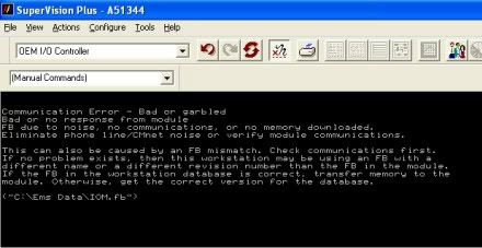

    Hey everyone...Here at our site we have a small network consisting of an LGE panel (which is the gateway, I believe you'd call it), a BACview panel and some other contoller at the rooftop unit. We have a PC running Supervision 3.02 as well.
    Supervision is giving this message:
    Communication error - Bad or Garbled
    Bad or no response from module
    FB due to noise, no communication, or no memory downloaded.
    Eliminate phone line /CMnet noise or verify module communications.
    This can also be caused by FB mismatch. Check comms first.
    If no problem exists, then this workstation may be using a FB with a
    different name or a different revision number than the FB in the module.
    If the FB in the workstation database is correct, transfer memory to the module, Otherwise get the correct version for the database.
    It says check comm, which I believe is good since the "connected" icon is visible and the panels are bright pink in the system tree view.
    Having very infrequent interaction with the system (and no experience with 'Supervision' ) I have no idea what could have caused this. The system is functioning as normal, aside from not being able to see anything from the Supervision PC though.
    It sounds like I need to do a transfer from the panels to the database to fix this? Not sure about that though... any suggestions? Thanks in advance.

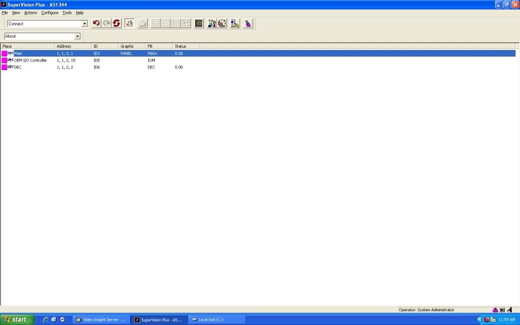

    Thanks for the feedback...now that I compare the panel icons color with another properly working (similar) setup in the building, i see that they appear more magenta colored than the "coral". I have attached some screen shots this time, hopefully they show up. Therefore, I don't know that I suspect any problem with the network. What do you all think?
    original message:
    also, the network only consists of one other panel besides the LGE gateway, thats the controller on the rooftop unit. there is also the BACview thing which I guess connects to the control panel on the roof directly as well. Not sure because it is located in a very inconvenient place (480vac power supply cabinet) which requires shutting down the unit to access.
    I believe the panel "Main" is the one on the roof that the PC has some issue with. I could try pulling the comm wire from the LGE, i suppose. Maybe these pics help a little.

    Regarding xarralu's post...coral (no com) is usually reserved for gateway module to field module communications (i.e. UNI16 to U341v+). Purple (no com) is reserved for modules on the main ARC156 network...
    Have you tried unplugging the ARC156 plug on your LGET as xarralu suggested and see if you can at least get at your gateway?

    The PC communicates interfaces with the LGE via a serial (DB9?) cable. My first thought was that the com port was not the problem because initially the message at the bottom right hand on the tree screen shows the lighning bolt (actively communicating with the panels), and then shows it 'plugged' in, and says 'connected' as seen on the screenshot. However, I will look into the possibility of a COM 3 problem (i think it may be a USB to serial converter). eg, double check speeds, settings etc.
    Other than that, tried to pull the network line off of the LGE... everything looks the same, same message, all panels show as magenta. So, not sure what to make of that yet.
