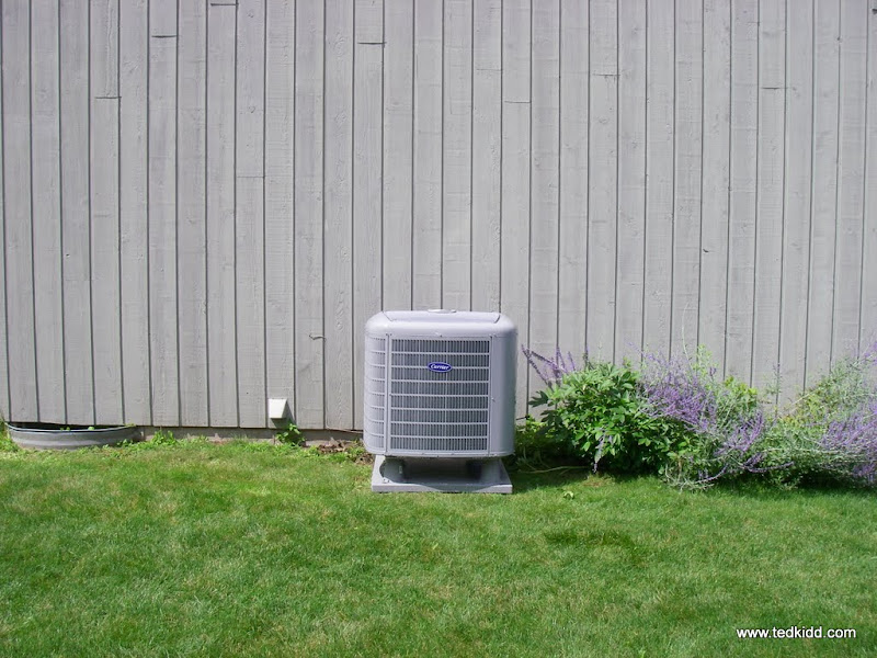

    For others wondering, they keep the pump up out of the snow;
