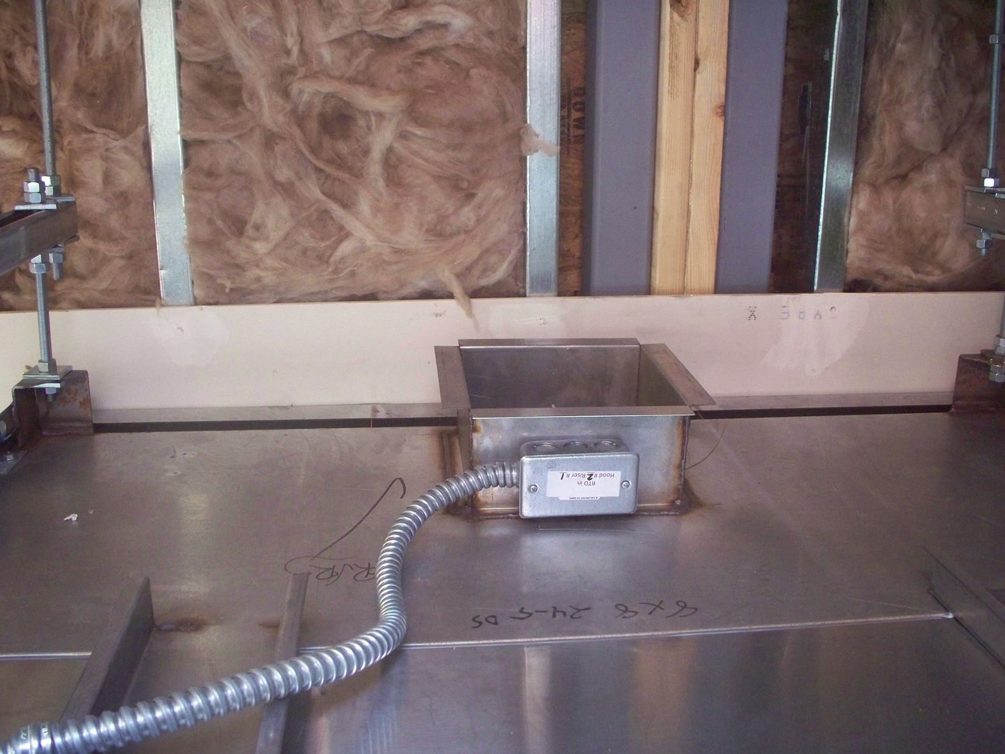

    Recently, I reworked a Hood Duct exhaust system for a customer. The unlisted 15' Hood provided many constraints and obsticles to properly size the duct. We were able to fit a 8" x 22'' trunkline on top of the Hood with 2 Exhaust risers centered on each side. The ductwork 90'd off the right side of trunkline( to the rear of the Hood), then transitioned to 16" x 16" (with 2 offsets inorder to get through the wall and obsticles) out the building 10' to an Outside Wall curb positioned at 45 degrees. The system passed inspection but needs to draw more CFMs as the Kitchen is very Hot and smokey because of the Radiant Charbroiler.
    Also installed was a Front PSP Make Up Air system.
    The Upblast fan is 2Hp 4750 CFMs.
    I'm thinking about changing the 90 to a radius corner and ending the Trunkline at the end of the Leftside riser( currently the trunkline extends 8-10" beyond the Riser).
    Any Suggestions??

    Depending on the appliance layout you may be able to insert blanks in place of filters to increase velocity over the broiler, etc. Any dead space like the ends that may not actually cover an appliance? Just be sure you aren't covering and fusible links of the fire suppression system.
    Is your make up air at a much higher CFM than the exhaust? If the make up is over powered you won't get the rolling effect under the hood and it will actually blow the heat and smoke into the kitchen. Have also seen hoods that were installed too high that would have the same result. Wishing I had kept all those NFPA books now lol Been out of the fire suppression field too long to remember all the codes and tricks.

    Kinda curious as to the hood riser to trunk connections, sounds like a good opportunity to have big loses. Was the volume ever measured?

    Why the trunk?
    Were there no risers?
    A flat horizontal plenum is not a good thing. Grease will settle out and it could create a fire hazard.

    The horizontals aren't a problem if they have the required clean out access and are maintained. The IF part is the problem.0
    I have yellow and red tagged many systems for that very reason in the past.

    The Hood originally exhausted out the back side of the hood, into a 200 year old New England chimney up three stories. The problem wes the duct was old fashioned galvanized heating duct with pourous seams. Fire Department wanted to shut down the kitchen.
    Above the Hood we had 8" of clearance, the large chimney behind the Hood and the "offices" above the Hood lead us to one route - off to the side and out the side of the building.
    The Hood passed including a smoke bomb test but barely at best.
    The kitchen Director did not want to change the Hood.
    My best solution was to remove the "unlisted" Hood and install a backshelf allowing me to use larger duct above the Hood.
    The riser are 2"

    2" riser????? What size is the hood. All ducts are to be continous weld and water tight.
