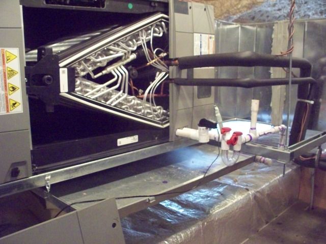

    Not there to check subcooling or superheat but the sypmtoms are similar to an undercharge or a restriction which would cause a loss of capacity. These can happen from improper lineset installation practises.Another capacity thief is flash gas. Trane recommends insulating both linesets when they travel through a hot attic. Is your attic hot? Here is an airhandler with both lines insulated. Does yours look like this?
    The 2.5ton worked fine before, and the new 3 ton doesnt. Both units would have close to the same capacities at 110*. I'm sure the airflow has improved with the new Trane unit......can you tell? Have you noticed stronger air currents coming out of your registers? Did anybody modify or change your filter grill? Did anybody change the type of filters that you were using? Does your home seem more or less humid after the new upstairs unit?
    I've never heard of insulating the liquid line when it runs through the attic. I'm in Texas and most air handlers are in the attic. I've been an HVAC tech for 25 years and have never seen that before. I just pulled the installation instructions for this unit off of e-Library and it doesn't mention that anywhere. I don't doubt you, but I'm interested in seeing where Trane recommends that. Can you post the literature number? Is that something new thats required on the 2 stage or R410A units? I'm a chiller tech so I don't work on much residential units anymore.

    Attached are pictures of our linesets from the attic variable speed air handler and garage variable speed air handler. Only one lineset is insulated. The one that is cold to touch is insulated the other one is warm to touch and is not insulated. The one in the attic travels a small ways in the attic about 7 ft. and than down the wall and under our house slab all the way to the opposite side of the house. They did install new filter grates in 2008 for both new unit in 2008(downstairs) and at the time the old carrier unit that was upstairs (attic). Haven't changed the type of filter we've used for years. We use the Web washerable filter it's black and silver, we have always made sure the filters and grate are very clean. Yes the air flow is better upstairs as one bedroom didn't have much air flow to it before the new unit. Today the downstairs was blowing out at the vents at 58-60 and the upstairs 65 we seems to be the case always with the new unit upstairs. Both Therm. set at 78. The old unit blow 55 upstairs (R22). Should I mention to our AC company about why the other copper lineset is not insulated? As far as humidity no noted difference in humidity.
