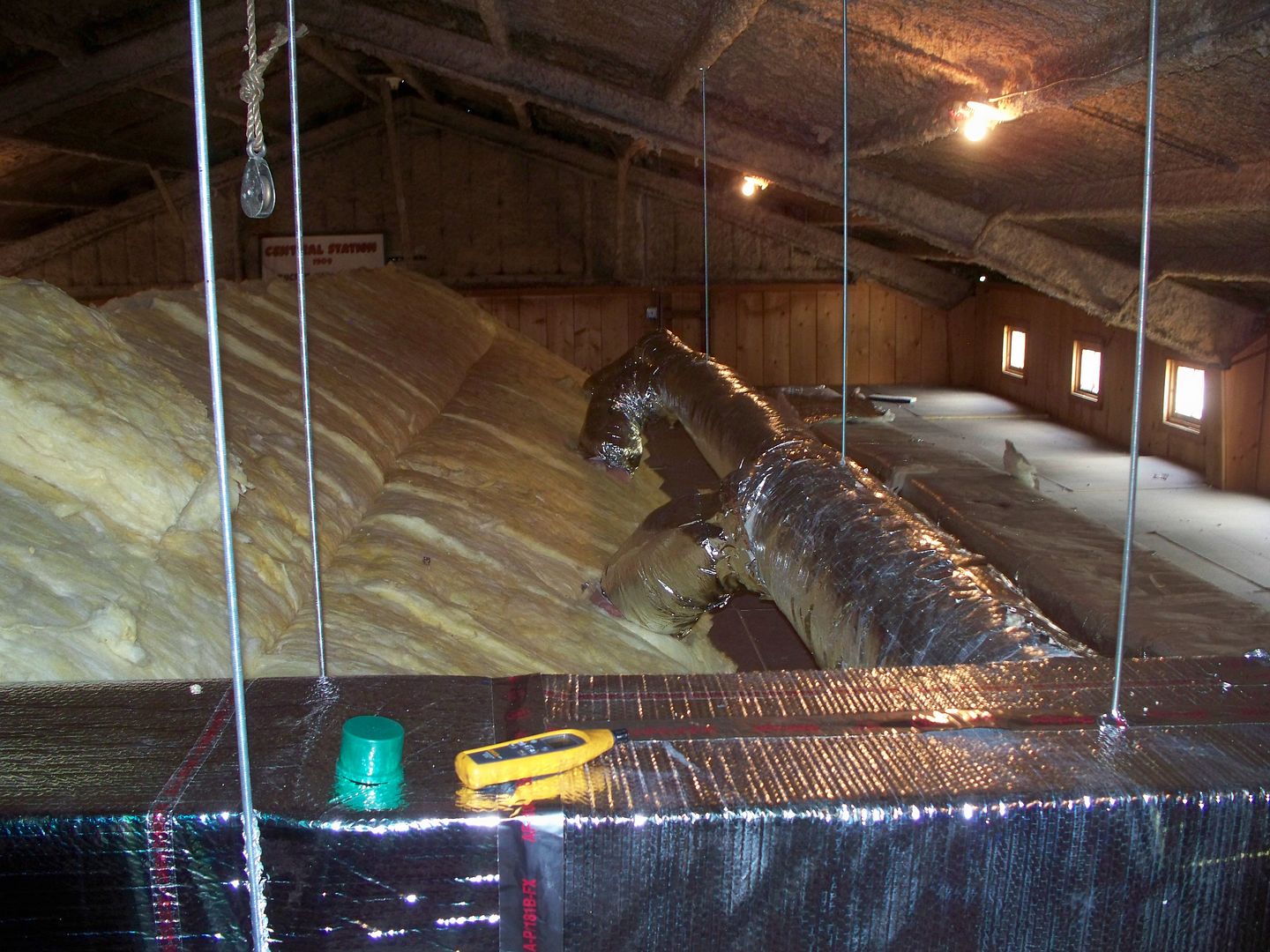

  6. #32
    Jun 2011
    3
    still here
    i was surprised to see so much discussion on here tonight... i had started putting the ducts back together last weekend and hadn't seen any comments or received any more email notifications, so i assumed it fizzled out.
    really interesting information, vapor and barriers and hot and cold and all the imperfections and possibilities still have me in a bit of a stupor, but there is a little bit more clarity on this specific application now... since it's a heat pump that'll be running in the wintertime, i don't even want to try to think about the impact of this setup in the reverse season. :-)
    it is a retrofit at my own home i'm doing and since i hadn't heard back i did end up wrapping some with the bubble foil, but still haven't gotten to the fiberglass or even completing a main part of the plenum with the foil. i was afraid of the "will create rust over years" and the "it's against code" comments. i'm just trying to think of how forgiving some of these materials will be over time with the imperfections (i'm trying as hard as i can to get perfect seals all the way through, but even with just the fiberglass i see there being tooons of imperfections with all the twist and turns and attachments at the plenum and boots. i used a can of foam at each boot and then did go forward with the bubble wrap on the branches and am going to be living in the house for about 2 more years so, i'll get to monitor the different sections and even deconstruct one eventually. what i know right now is that what i'm doing is about 1000x better than what was there. the old fiberglass backing has tearing all over it and there were cracks everywhere in the ducts and the old fiberglass was very dirty because of this.
    i'm thinking that if can get a radiant barrier up and bring the attic temperature down significantly and continue to try to get that perfect seal and i might be able to avoid mold n rust depending on the level of error forgiveness my climate and specific materials will allow. i did ask the original questions thinking about the long term as many of you seemed to have picked up on. i'm not really worried about the next 2 years, i'm thinking if this could actually go 20 years and be better off then the horrendous state of what i saw as i began to deconstruct for the retrofitting. my guess is that by the time any problems from what i'm doing present themselves the next owner will be a little wealthier than i am and that the materials available locally and the science of it all will be more understood by the town folk n contractors. and also just to clarify further now that there's been an open discussion: the whole reasoning behind using the bubble foil does even have anything to do with the radiant blocking or insulation properties... it has more to do with creating an additional layer of sealing around the duct to avoid any imperfections in my mastic sealing and aluminum taping of the metal from creating infiltration points that pull fiber glass and asbestos dust or just attice air into the ducts and the home. i'm realizing quickly that there are imperfections throughout it as the labor is just so frickin intense and hard to get right in some spots.
    so... yeah... i may have just made some serious mistakes on some sections but scorp and the guy talking about the difference between what he actually sees in the field vs the theory gave me a little reassurance that'll go along with the fact of knowing that i am doing the job much better than it had been before. i'll monitor areas over time and who knows... if i end up settling in this house i'll search out this thread 10 years from now when i'm hiring some kid to redo all my rusting, molding ductwork and post an update. :-) i really do appreciate the insight and the discussion. VAPOR is something that has been fogging my brain for a long time... particularly with all these home improvement projects i'm doing and building science research i've been doing on the side for mine and my future family's benefit. i just want some air that's cold damnit! i'm tired of being without a central unit (this'll be my 3rd summer if i don't get it fired up soon) ... :-)
    again... thanks. i hope ya'll were able to learn something (nucleation???) as well. take care... i love the internet because of forums like this. also, i don't want anyone to think the DIYer like myself that drops in here are trying to steal professional advice or trade secrets... i'm just trying to clarify information with people who might have a little more hands on field experience than me. if there's anyone in dallas / fort worth that's been a part of this thread send me a private message and i can give you a little work with my system. i don't want to do any of the silver soldering myself (don't own the torches) and could use help perfecting the air flow settings and refrigerant levels, checking for leaks, etc. i've done all the textbook stuff and a majority of the field work on my own, but there is always a place in the DIYer's life for the pro's to step in and take over.
    i appreciate ya'lls insights,
    eli_d

  9. #35
    Dry as a bone Tucson
    4,841
    Double wrap
    Eli
    Sorry I missed this thread at it's birth.
    But I like the way you think. I just do it the opposite of how you did.I line the interior of the duct with insulation and then wrap it with bubble wrap.This stuff is great at deflecting radiant heat. I have a duct system in an un-insulated attic that consistently gets to outdoor ambient PLUS ++++.
    There is only 1 degree on gain in 60' of duct run....
    How did it turn out?
