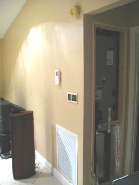

    Most know mine and others setup by now. Small 887 ft condo, new ac/furnace.
    The hallway closet right off the living room has a large return cavity below it.
    It was making a helluva noise. I tried lining it with 2" 80% cotton roll from a soundproofing net site. It did wonders for the sound...only...it sucked up
    the smell from that stuff.
    I know DASH has reply posted about vanes and right turns...but that just doesn't work when the HVAC closet is practically in your lap.
    I ran the AC and was gone for 4 hours...when I got back, I could "smell"
    that "quieting" material I bought off the net. Natch. Whatever I line my
    return cavity directly below my HVAC closet is going to transmit the smell of same
    thruout my condo. Lesson learned (imagine what the smell will be like when I run my furnace). I will now do as many suggested here
    and settle for lining that return cavity with nuetral smell plenum board/duct board.
    Question: Duct plenum/duct board has silver paper on one side...fiberglass
    in the middle..and a thin neutral smelling sound absorbing material on the
    the backside. Instead of having the silver side out, should I reverse it and
    have the sound absorbing part facing outward?
    Also, In my zeal to quiet my hallway closet HVAC, I lined it (after they lined the closet with ductboard) with a closed cell foam blocking/absorbing material. Again..off one of those "sound absorbing"
    net sites. Well...that stuff kinda stinks of "technology" as well. I may rip that out.
    Most here deal with big homes and well established systems and ductwork.
    Have pity on the small condo owner. Don't tell me that my AC company should deal with
    noise..cause they just don't want to deal with it. I do.
    Replies? Keep in mind my HVAC is in my lap...not down in a basement.

    Most foam materials off-gas for a while and then settle down, unless heated or exposed to solvents.
    Most cotton materials are treated with Lanolin at some point in their processing.
    You might try washing the sound absorbing material and letting it sit out for a few months.
    Curiously, it doesn't matter much which way a soft-sided panel is laid. When hit by sound from either side, the hard side will reflect much sound, and transmit the rest, and the soft side will reflect almost none and absorb only a little. The cumulative affect is about the same amount transmitted through from either side. The only difference is which side you get more echo on, well, that and aesthetics.
    -HF
    74,905
    Its the roughness of the fiberglass that absorbs the sound.
    The fiberglass should face teh noise.

    From your pictures,vanes and/or ductboard baffles could help.However you need a Pro to test the static,if you use baffles,due to the restriction the create.Ductboard for baffles.

    Is the furnace DV?
    Pulling combustion air from the space must allow the burner noise to filter in.
    A sealed combustion/DV system would have helped. Having the return directly
    next to the unit doesn't help. I suppose getting some return ductwork up into the ceiling
    is out of the question.

    I guess I'll have the silver side of the plenum board facing out towards the sound, thanks for that advice.
    I still have that black closed cell foam lining the closet area.
    If I continue to detect any technology smell from that net bought black closed cell foam (no formadahyde used), I'll take that out and put in some more plenum board. I need to run the furnace to check for the smell. I ran the furnace for
    an hour and the warmest that fire retardant foam got was about like a heating blanket on full. The closet itself is pretty well sealed off from the return cavity, so I'm hoping no residual smell from foam will make into the system. If so...it gets yanked out. First things first tho...redo the return intake as that is where
    some of the smell is bound to be coming from. Not terrible, but noticable.
    I bet if I hung that 2" 80% cotton material on a clothes line for 6 months it would probably neutral out, but I don't have the place nor the patience.

    Okay, I'll bite. I'm just tuning into caslon's posts now....and am wondering... why is there a 2 ton system installed in 900 sq ft? Why are the vents so few & so small? Your system might be oversized (might be spot-on, depends on the heat load calc... tough call without seeing the place). At the very least, your ductwork and supply vents are far too small. Until you correct this, any other attempts to quiet this system will be useless.
    For comparison, here's an except from the engineering calcs on my system. I should note that everything was sized to handle 800 CFMs when doing noise calculations. The maximum air movement the system will produce is 770 CFM and will only happen at conditions not normally found in Florida. Normally the high stage runs 651-700 CFM, low stage 250-417 CFM depending on temperature/humidity.
    Here's the sheet:

    I've got you beat. Take a look at my setup:
    My air handler's practically in the living room, and the return grille IS in the living room. That return grille is feet away from that B&W 803D speaker. There's barely 1" of clearance around the unit in that makeshift utility closet.
    The entire condo has 12" ceramic tile on a concrete slab. There's large windows on 2 sides of the living room and vaulted ceilings throughout. In other words, an acoustical engineer's nightmare. Even my furnishings aren't helpful -- leather couch, glass & granite tables. All highly reflective surfaces.
    Even with the access panel removed from the wall, the system's inaudible under normal operation. The only way to know it's running is to look at the thermostat or kwh meter. Even the service techs are in disbelief that it's running until they feel the refer lines and feel the vapor line feeling cold, and that's standing right in front of the unit.
    I do all of my audio mastering and mixdown in that room, with the air con running the whole time. The only time the system is even remotely perceptible is when it's running >700 CFMs, which is rare, only happens when the system is recovering from a setback on a dry, hot day and I use 85F as a setback. When I say "perceptible", that's literally the best way to describe it -- you can just barely hear it at the return.
    My brand new $2k fridge is louder and I still hear the ticking of my wrist watch over it, and this is with the system running full-throttle under conditions the system isn't likely to be run under. Invariably the system usually has some humidity removal to contend with, so even on the 2nd stage it's running at < 700 CFM and is quiet enough for me to even record music or do a broadcast in my living room. Numerous broadcasts have been run from the room since the installation of the AC system. All of the supplies remain dead-silent under all conditions.
    I want to note that ALL of this was done without any special sound deadening material. The closet was lined with ductboard, but that's it. On the return, the ductboard is actually reversed (shiny side facing inside the duct) to prevent mold growth below the coil, which actually hurts the acoustical performance of the system. I want to reiterate that this is one of the worst rooms you could design acoustically, yet this is one of the quietest systems the contractor has ever installed.
    Air noise is directly proportional to velocity. The larger the ducts & vents, the slower the air moves and the quieter the system will be. There's no reason why any modern HVAC system should be audible. You want a quiet system? Fix your ductwork and increase the surface area of your supplies and stop farting around with sound deadening material.
