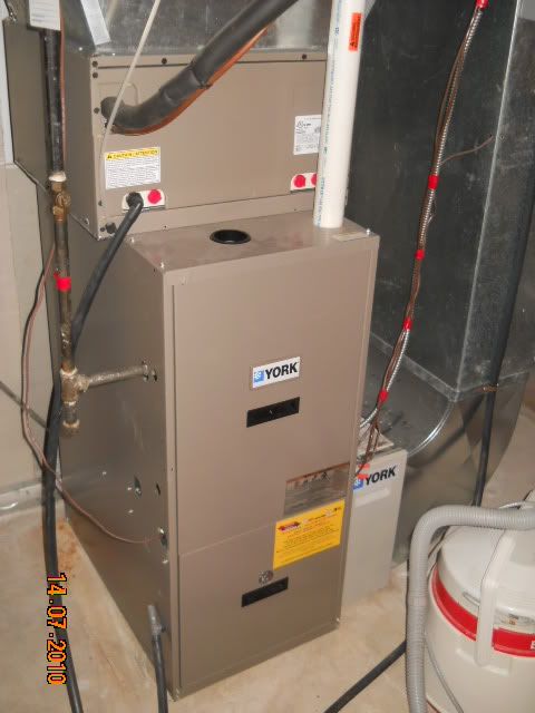

    A customer of mine had a York GM9V080B12UP11D furnace installed with a CZH03611A condensor and PC43C3XN1A coil. I'm looking for the ARI for this combo and the efficiency rating for the furnace, and whether it comes with an ECM or PSC motor, but according the the Natural Resources Canada website, there is no such furnace by any manufacturer, and this doesn't come up on the ARI website either. If it doesn't exist, how did it get in this person's house?

    That is a Goodman model number. 2-stage, (3 ton drive) variable-speed, 80,000BTU, 95% AFUE
    I agree, it looks close to a Goodman model number but here are pictures of the unit and the label inside the furnace:
    Also if it were Goodman it would be 45 000, 70 000 or 90 000 btu, not 80 000.
