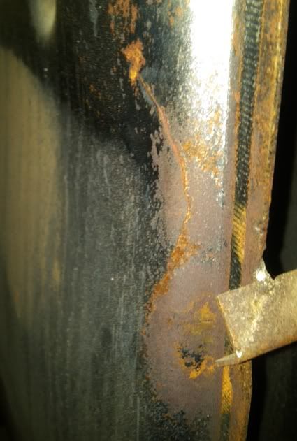

    To give an example, several yrs ago for the sale of the house…the buyer contracted us to check out the furnace and A/C. It was April and I found 3 cracks in the old Westinghouse furnace.
    The seller was not home at the time. Freaked out because another company had just done a furnace tune up in Nov of the prior yr, so they called them back out to prove me wrong. The tech (obviously inexperienced) said there were no cracks in the furnace.
    I then met the buyer, seller and both agents at the house and removed the back of the furnace…because on this model you could do so, since it was made to be removed. I showed them the cracks you see in the pictures below.
    We changed out the furnace, kept the buyer as a customer and gained the seller and both agents as new customers as well. The old furnace now is one of my training furnaces that I use for new techs…oh and the day we changed out the furnace I drove to the company that said there were no cracks in the furnace and showed it to the service manager, so he could see his tech needed some training so he would not kill someone.
    These cracks as you experienced techs know are not always easy for a customer to see looking through the burner openings, even with a camera sometimes...but are very easy to see when looking at a pulled exchanger or one where the back can be removed.

    I do not think those little closed cracks in post #18 would show up on a CA or supply CO.
