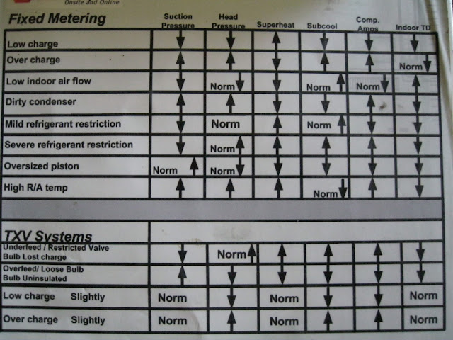

    Is it possible to have high superheat and high subcooling at the same time?
    If so what would cause it???????
    Nov 2007
    427
    Yes..what type of metering device?
    Nov 2007
    427
    A restriction in the refrigerant line, sensing bulb lost charge.
    Last edited by hidalgo1301; 08-13-2010 at 02:29 PM. Reason: wrong information..oops
    Nov 2007
    427
    Here is a picture of a 'cheat sheet' that you can reference.
