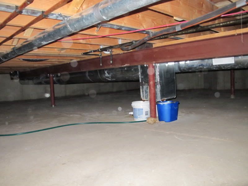

    I discovered a wet floor under the plenum and noticed the water was coming from the plenum. I opened 1 corner and a lot of water poured out. We have discovered some water the past 2 summers, but this year seemed worse.

    There is no sign of frost. The house cools fine. When the unit is on, there is a steady, immediate, trickle coming from the pvc pipe. And there is also a stead trickly coming from the bottom of the plenum in the crawl space about 5 minutes after the unit is on.

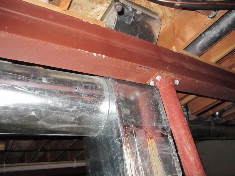

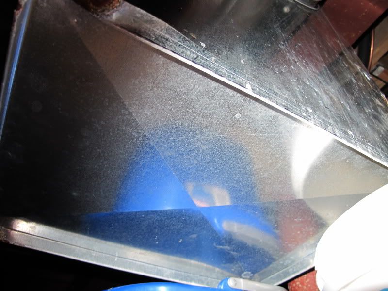

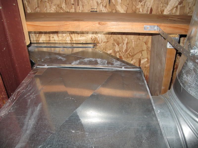

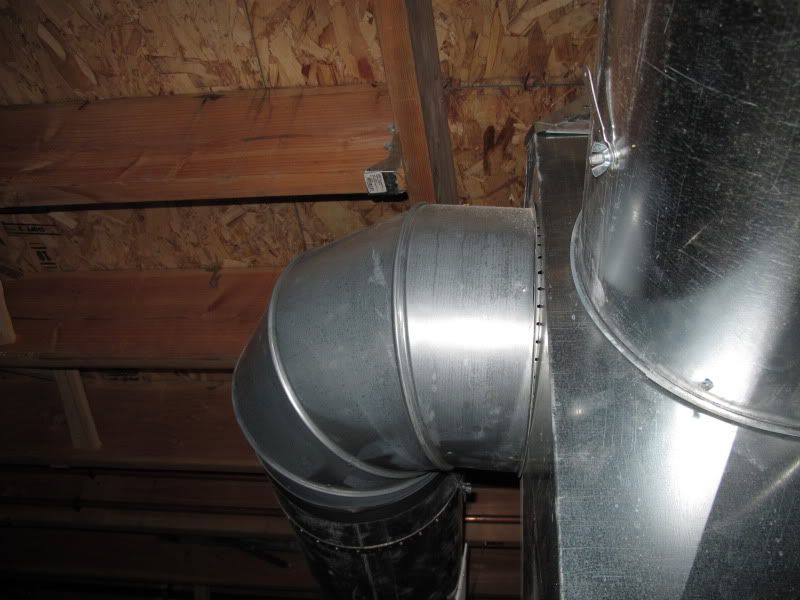

    Here are some pics (I can get more if needed)
