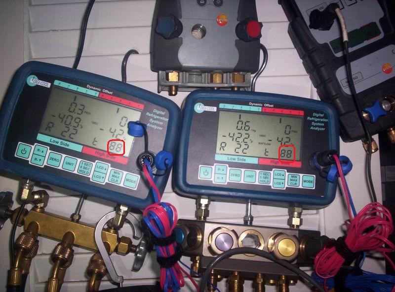

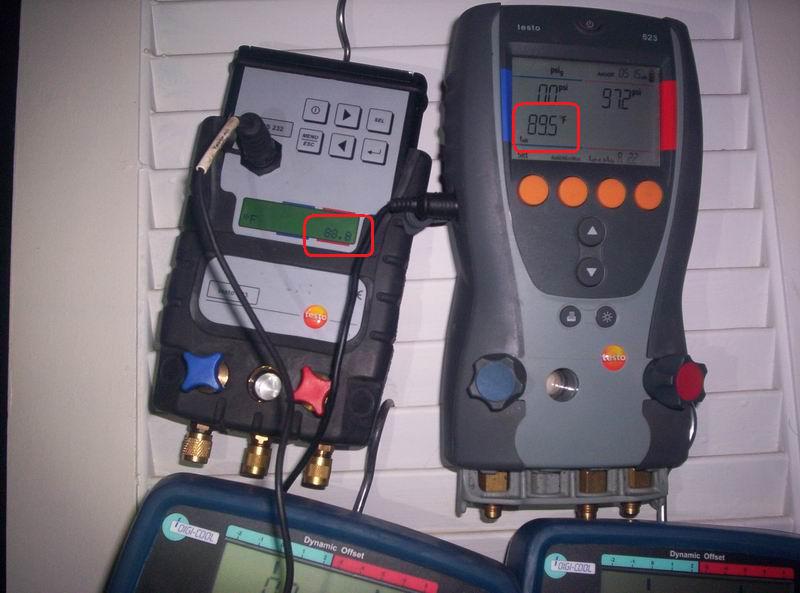

    Decided to hook most of my pipe temp stuff up, just for grins.
    The instruments.
    The probes. One of the Testo 550 probes has some slight temporary improvements.
    1st and 2nd gen 523's
    2 Digi-Cool DRSA-1250's.
    Note the difference in the 2 temps on the 550. This is after fussing with the probes a lot to get the max reading I could get.
    The higher of the 2 is the probe with the orange weather strip on it.
    The probe in the Fluke 52 on the left, and the Testo probe in t2 of the Fluke 52 on the right are the probes I use, the other is out of my junk drawer.

    Mark on the 550 clamp that you're working on you might try to pull that sensor into the clamping pad area 1/4" or so.
    I am only guessing but think some of that metal jacket on the cord end is to conduct to the wire itself and the actual tiny sensor inside there is located closer to the tip that is dead ended anyway. May help with centering also having the sensor closer to the middle of the clamp pad as well.
    Also comparing the 523's gets funny at a point.
    The time I've seen a difference like that or greater there is a difference like that where you have them mounted
    (temp of the pipe and temp of the room ambient)
    Is that the PT-100 Clamp on top of all those sensors there LOL
