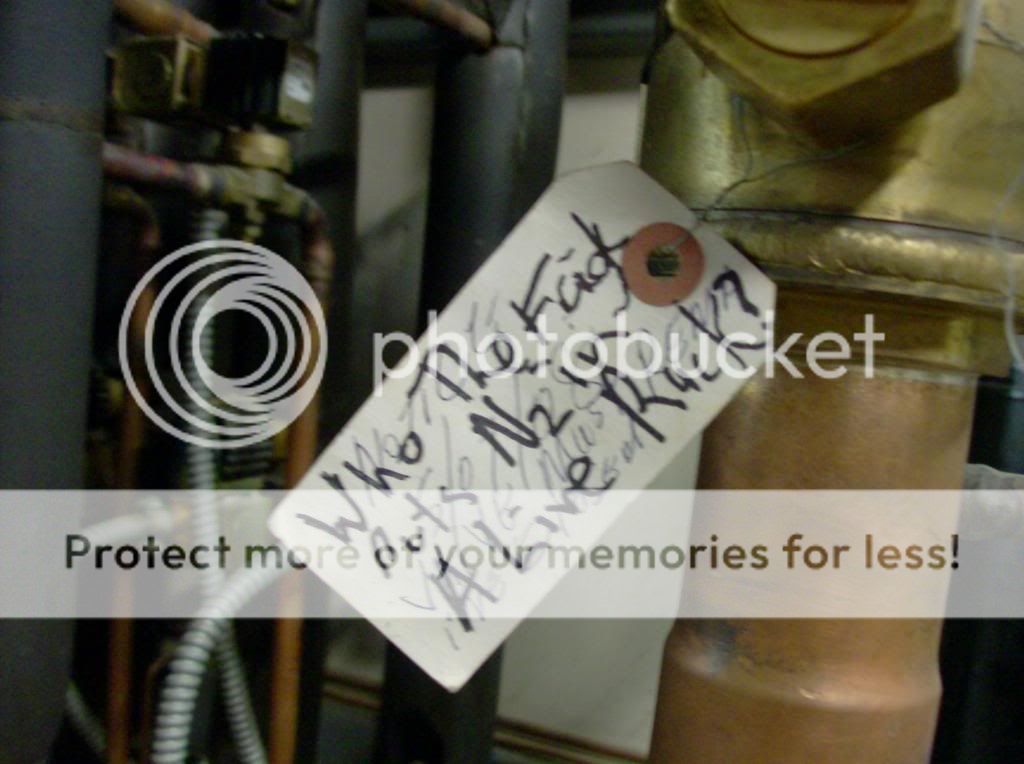

    why cut and isolate....... i've found it done before and even tagged that it was done
    roll eyes now
    hhaha
