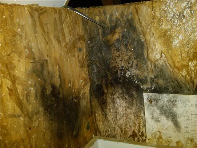

    Here is an interesting example I came across: The homeowner has a newer house (less than 10 years old) with R50 attic insualtion, R20 walls and decent thermal pane windows, which had condensation issues. They were buying new windows with the hope of solving the condensation problem. I suspected high humidity since the windows were decent, and the blower door test confirmed that the house was extremely tight. Now the new windows (triple pane, low-e, argon) may have helped reduce the moisture level on the glass due to the higher temperature of the glass, but this does not solve the problem of high humidity. When I opened the attic hatch here is what I found:
    This is probably happening inside the walls as well. I noticed the house had a humidifier that was set high, I suggested that the humidifier be disconnected, and if necessary a HRV installed if high humidity levels persist.
    This is an example of a very tight, poorly ventilated house with many occupants (5 people in about 900 sq. ft), and from what it sounds like, the opposite of what you are experiencing, just wanted to illustrate the other end of the spectrum and an appropriate application for an HRV.
