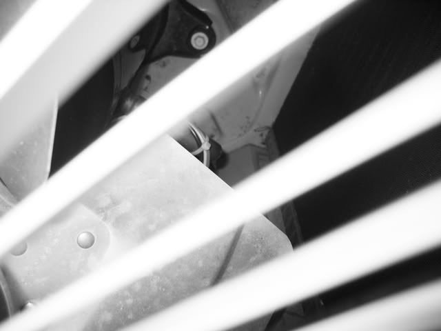

    Wires have to be strapped tight to the suction line of a compressor or they will rub if left loose eventually short. You'll find this info from copeland in there tech data on replacements...
    Think about it, every single Lennox unit has the compressor wires TIGHTLY zipped tied to the suction line. Carrier units with the big door on one side are the same way (dont know the model number). When have you replaced any compressor and not had to cut the tie for the compressor wires when replacing a compressor to keep from melting them?
    I just walked outside to verify what I was thinking. I went to all the neighbors units (condos) because theres are easy to see. So I took a pic..
    Sorry its in black and white I was taking a pic for my avatar and forgot to turn it off. Anyway thats a factory zip tie. I dont doubt you have seen one of these short but we are talking probably a million plus units pretty much everything with a Copeland compressor is like this from the factory...
