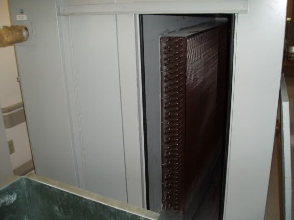

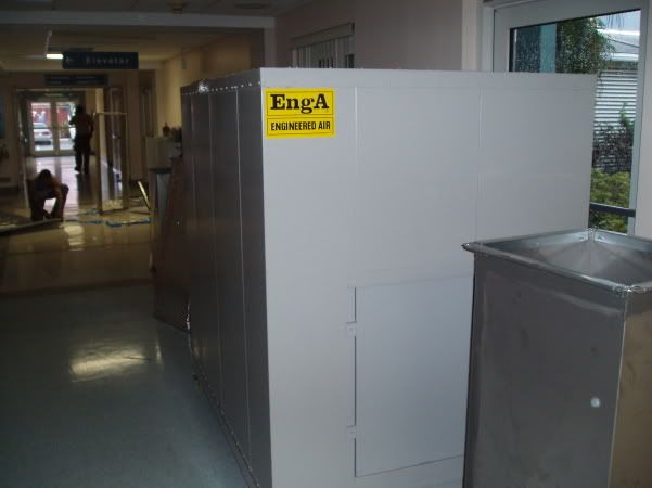

    I have a challenging project here, constant volume of air for high fitlration rates, a high amount of outside air and I have to maintain 68F and humidity in the 50 to 60% range. No outside walls, no roof, no external heat gain.
    So I am using a custom chilled water air handler with a built in 7.5 ton dehumidifer.
    Had to have it built in two pieces it has to fit through existing mechanical room doors.
    This is the coil section, you can see the 2.5" coil connections for a chilled water coil in the back. The coil visible in the front is a heresite coated condenser-reheat coil
    This is a DX evaporator coil which is down stream of the chilled water coil and upstream of the condensing coil
    This is the compressor, it turns on when there is a call to dehumidify, its DX coil gets air down to about a 48 dew point, the condenser coil reheats the air and when combined with the heat the fan and motor add, it will supply air at 65F with the low dewpoint.
    Blower Section
    BAF fan and 15 hp Premium efficiency motor - there are external filter banks in the duct work, fan will be up against about 6 inches of total static

    its up and running now 3/4 commissioned. I expect to get complaints it is too dry in there now
    It is not under a full load yet, was sized for a bit of an expansion. So far holds about 69F and 40% RH. I can drop the temperature it maintains easy enough, I can also raise the humidity as well.
    There will be an increase in fresh air on it in the near future, I figure it will naturally hunt towards 50% RH
    When it goes into dehumdifying mode it blows 65F bone dry air. This is all internal loads so space temp will hold about 6 degrees higher than the supply air temperature at the moment.
    I use the dehumidifier as a reheater when it gets to cold in there as well. So the 'warm it back up' function at the moment is pushing RH down low.
    So if it gets too humid it blows dry 65F air, it gets too cold, it blows dry 65F air.
