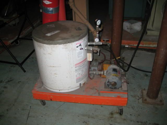

    I'm pushing for a portable boiler to leak check machines and getting some flak about it.
    First job I get sent on to leak check a chiller, I ask my boss: "so where's the boiler" He says the customer has one onsite that I can use. When I get there, this is what I found:

    So when the "home made" boilers explode and you or someone else gets hurt or worse and the appropriate authorities investigate and find that the "home made" boiler has no ESA or CSA approval stickers on it . WHO'S A$% is on the line ????????????????????????????????????????????????
    JMHO........

    Double bogey, thanks for the link.
    Don't worry, I didn't actually use it. The customer had it hooked up when I got there, but I disconnected it and found a hot water source close by that I could use (boiler room was next door).

    I have used the heaters lots. They don't have any fusing so it is kind of spooky. But you can't beat a boiler. You gotta make sure you don't go too fast. Once heated a CVHE500 with R-11 to 8 lbs in 2 minutes. Scared me I thought it would get the rupture disc before I got it shut down. The stress coulbn't have been good for it. We converted it later, that was 15 years ago, I think it is still running.
