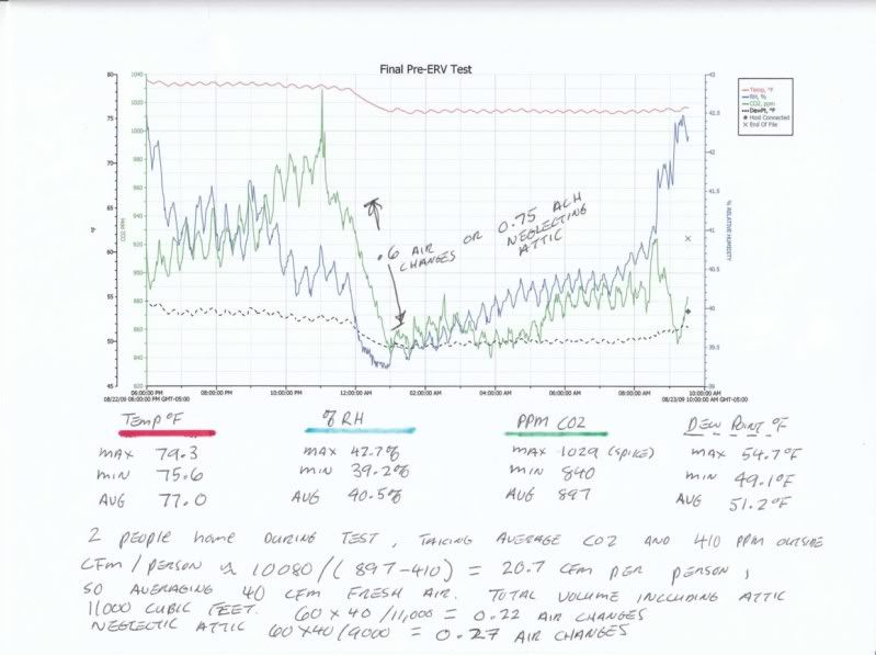

    I have a pretty tight house, no problems with humidty, no shortage of fresh air. I received an ERV to test out, it is the type with a wheel, it sounds of simialr capacity as yours. I advocate intermittent ventialtion so that I can treat the air as I bring it in.
    SO I am running the final test on my home just before I get the ERV going. Right now, I force in 80 CFM of fresh air with an inline fan whenever my compressor runs. I have about 80% of my glass covered with galvanized hurricane panels at the moment so what you will see is the effect of oversized air conditioning in a tight home.
    So you can see the place averged about 77F, 40.5% RH, CO2 897 PPM ( 487 above ambient) and a dew point of 51.2F. I use no dehumidifier.
    I should be able to easily add even more fresh air without breaking 50% RH and I intend on doing this with an ERV. I will try 120 CFM when the system runs, and I also intend to add a CO2 sensor to kick it on, but I have a feeling this will rarely happen in my situation.
    I have a small home, I have a sealed attic and I condition it with about 30 CFM of supply and return air. So if I include the attic in my ACH rate it is about 0.22. If I neglect it, then I was averaging zbout 0.27 ACH.
    Now, you may notice something here, I have put graphs with the same characteristics up in the past, and my critic here always seems to miss the point.
    I usually keep the place on the warmer side up around 78 or 79 and with my very low humidity and some ceiling fans this is usually quite comfortable. But this past April, I had a house full of visitors, so they are not acclimatized to the warmer temperatures so, I set it down a few degrees at night so it was easier for them to sleep and it also gives some more fresh air.
    So since April, I have been keeping this strategy and now with just the two of us it keeps CO2 levels about 200 PPM lower this way.
    Now teddy will like to say how an air conditioning system recovering from a temperature set back runs for a while and gives good mositure removal. This is of course very true and you can see the RH in a tropical home dropping down under 40% RH. WHat you will also see, is the tropical home getting purged with fresh air.
    During this recovery period, if you count the total vloume with an attic, during the recovery period there was 0.6 air changes happening and this is precise, so many known, measured CFM vs so many minutes, this is not a CO2 estimate. Again if you were to neglect the attic it is more like 0.75ACH.
    Now during the week, every day, the temperature is set back and this very same effect happens. The system does not run at all during the day, and then runs bringing down the temperature, humidity, and CO2 as it recovers.
    Anyways, I will keep this test on for a few days for a good baseline of a home with oversized AC, then later I can compare it to an ERV.
    I am actually looking forward to some higher RH, as I find my throat is very dried out every morning when it starts dipping down below 40%.
    I should of ran the test when my filters were dirtier, it tends to hold under 40% without a dehu.
