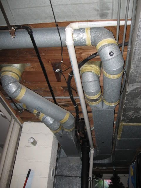

    Not sure if this is Wall of Pride or Wall of Shame? I put it here because, if anything, it's been functioning for 15 years, though the secondary HX is clogged with rust(said the last tech that was here). Furnace was installed 12/21/95, not sure when the A/C was done.
    It's an Armstrong 45k BTU NG 90% efficient(guessing on that) furnace with an Armstrong High Efficiency A/C.
    Does the install look good?
    What about the duct and lineset?
    The straight pipe on the left side is for furnace, the one to the right is for the NG direct vent HWH. Does this part of the install look good?

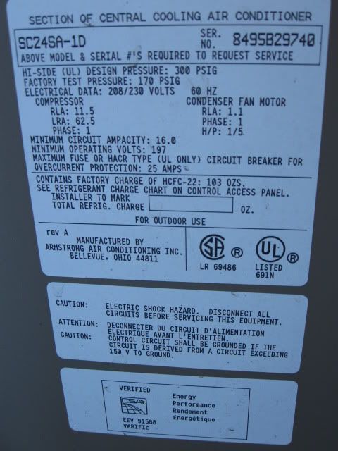

    Can anyone tell the SEER and Tonnage from this tag(located on the Condenser)?

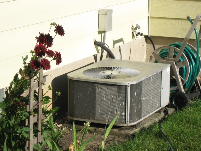

    Lastly, this is my neighbors condenser, can anyone identify the brand?

    That condenser is 2 tons - not sure about the SEER rating. (Most likely 10)
    The install looks average to the untrained eye -

    The neighbor's is a very early vintage Goodman.

    What is it with the butt connections on the return drop?
    I see that a lot around here.
    So that means it was made Circa 1982 then?

    Looks like it could use a wire guard for the coil fins. Getting a little beat-up over the years. It's mounted a little close to the structure for ideal air circulation.
    orginal install been there for years.. you can say they have gotten their money out of it-- they sure don't make stuff like they use too

    It's kind of funny because she just had the furnace replaced this spring but opted not to have the A/C redone.
    It's doesn't sound like most A/C's. You can't hear the compressor, but the fan sure is noisy.
