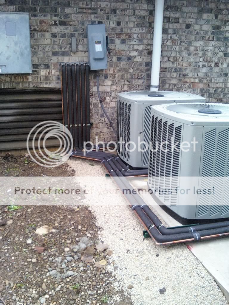

    Our installers not my work
    Finally we where given more than enough room
    Dry as a bone Tucson
    4,917
    No Electrical
    Looks good, except for the reduced clearances between the cu units,I believe the minimum is supposed to be 30".

    Indiana
    3,228
    electrician has not been there for weeks..installers paperwork said 11"..so they say, i did not read them.
    4,917
    installers guide
    Quote Originally Posted by yellowirenut View Post

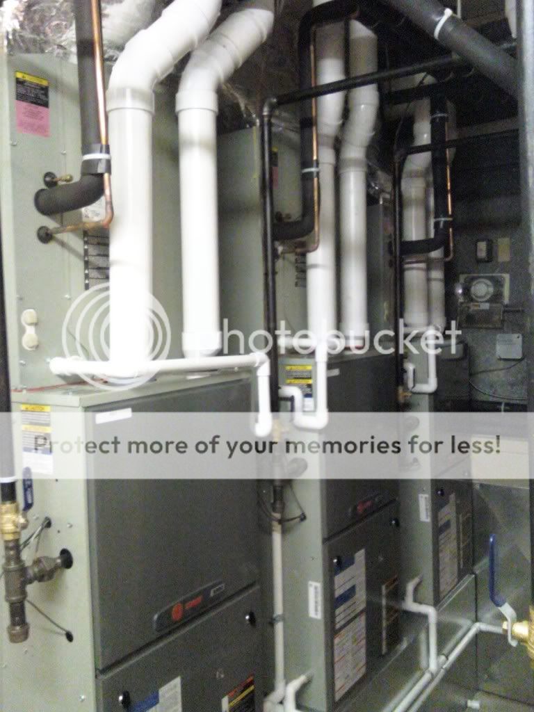

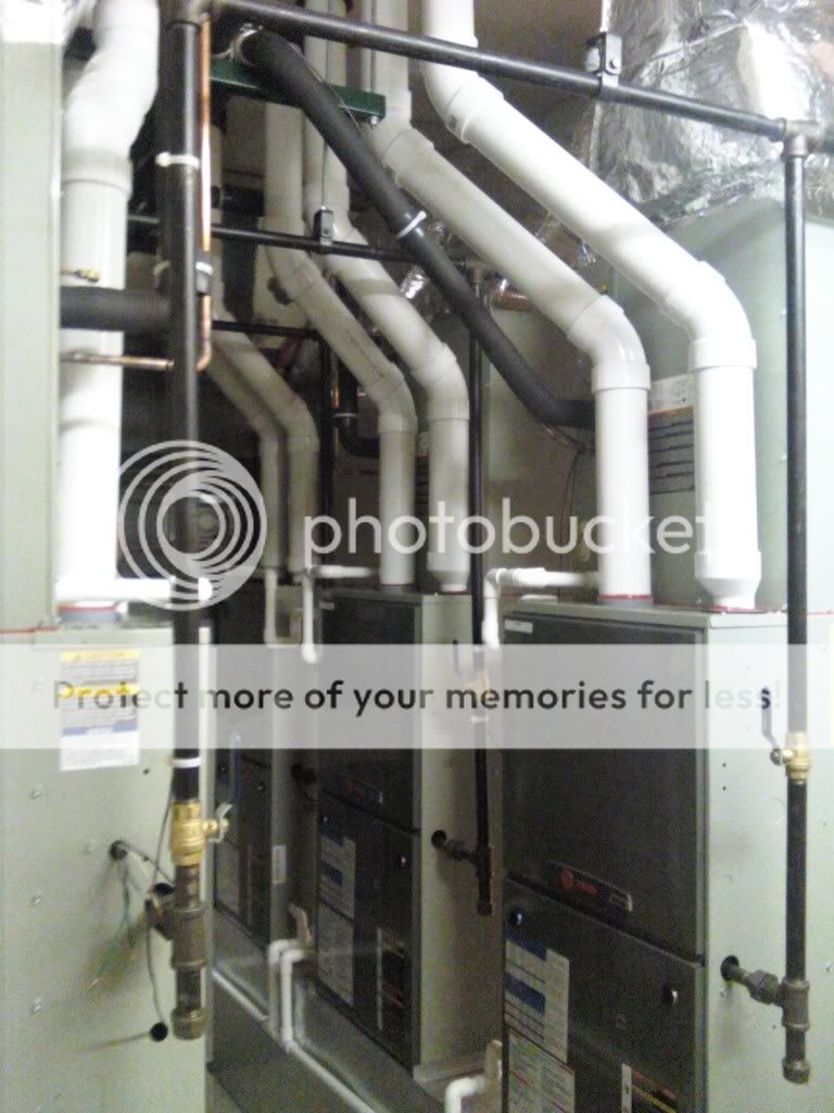

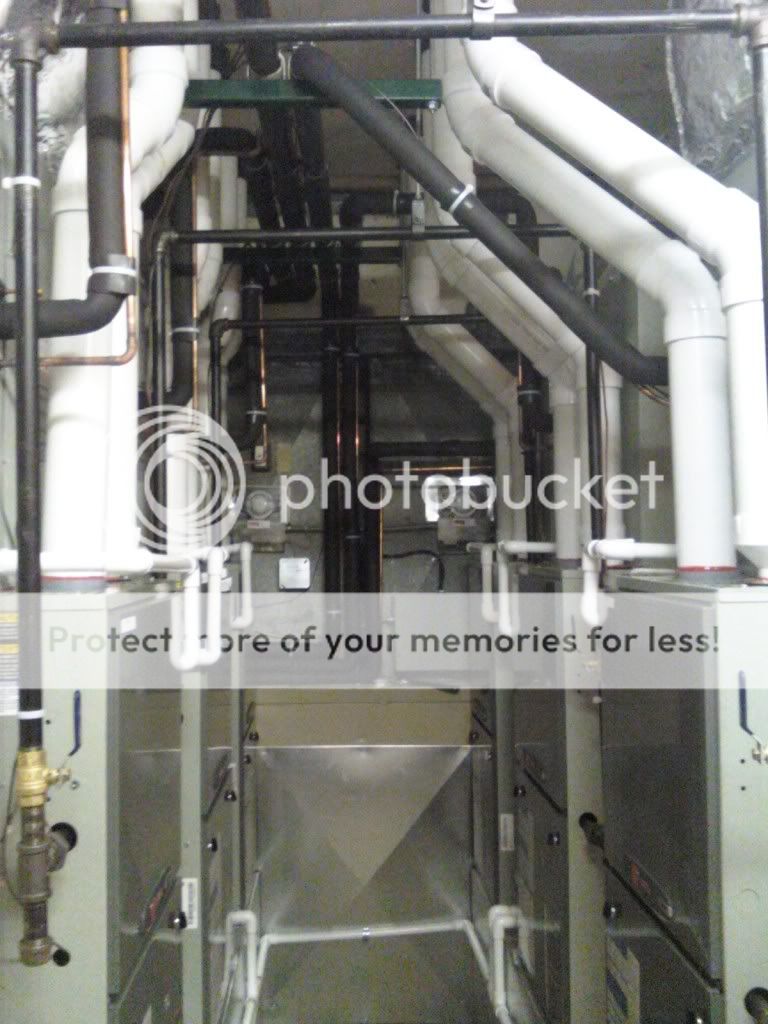

    Guide says 12" from wall, code says 30" at access, guide says unrestricted on other remainig sides(2x). Most will do 24" which is what it looks like your guys did on the outside units. The furnaces by code are supposed to have 12" added to thier dimensions for min. clearance. That is some really clean work. Im guessing that the furnaces all share a common return?
    John Proctor
    Watchman Nee
    Indiana
    3,228
    correct...with the common return. the original was a lennox monster. One unit and dampers for temp control...never did work right we where told. Now the south facing units can be cooling wile the north ones are heating
