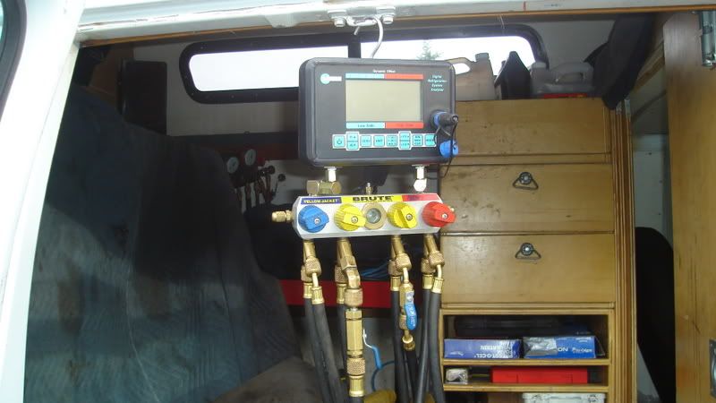

    Black hoses are my ultimate goal, but Ill have a hard time giving up my 4 valve manifolds. Maybe if I ever convert Ill paint "NITRO" over the "VAC" knob
    Quote Originally Posted by local553 View Post
    take your valve stems out and see how quick it pulls down.
    I was just thinking about this the other day. Everybody talks about our VCRTs but nobody ever mentions pulling the core depressors out of their lines.
    720
    Quote Originally Posted by AccurateHT View Post
    I finally got around to a more thorough test and it looks like only the high side ball valve leaks under vac. and only at 3/4 closed. The others just hold ALOT of air and it takes several slow cycles (open-close-open) to clear them
    Either one of these work as well.
    Rapid City, SD
    7,416
    Since you have 2 sets, you could go ahead and ship one to me, I'll store it in my van for you... you know, help you free up some space in your van.
