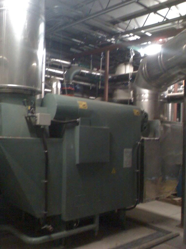

    The store is partially powerd by 6-55 KW natural gas generators, the flue gas off these generators is pumped into a heatexchanger in the boiler room.
    The gerator exhaust is then ran through these two heat exchangers. I was geting a 10º rise off these exchangers. The exhaust gas temperature entering these heat exchangers runs around 650º.

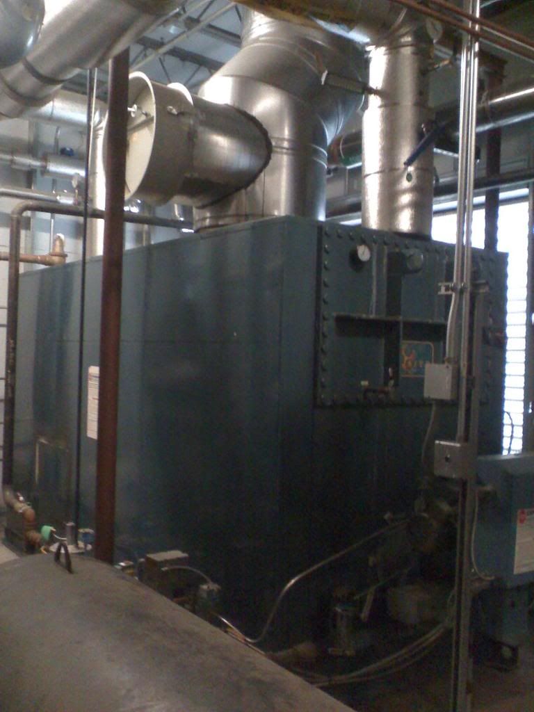

    And this bad boy is the guy that gets the work done. This 7 MBTU/HR Rite boiler can take care of the whole facility on the coldest of days. It was around 60º today and the main boiler only fired once the whole day so the smaller boilers and heat exchangers do a good job of keeping up on mild days.

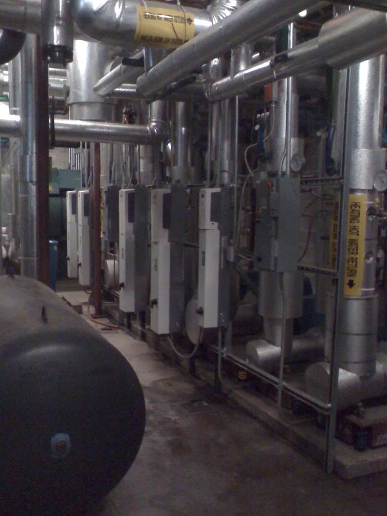

    The main heating and cooling loops are circulated with 4-20 HP VFD motors.

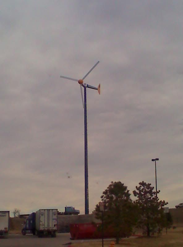

    Then on top of all that they have a couple arcers of solar pannels on the roof and this.

    Due to the higer cost in natural gas and the cost of electricity the generators would be shut down in the summer and they would use the solar pannels and wind generator then rely off commercial power. The gernarators need 60 - 80 PSI of natural gas to run each generator has a copeland gas pressure booser installed.
