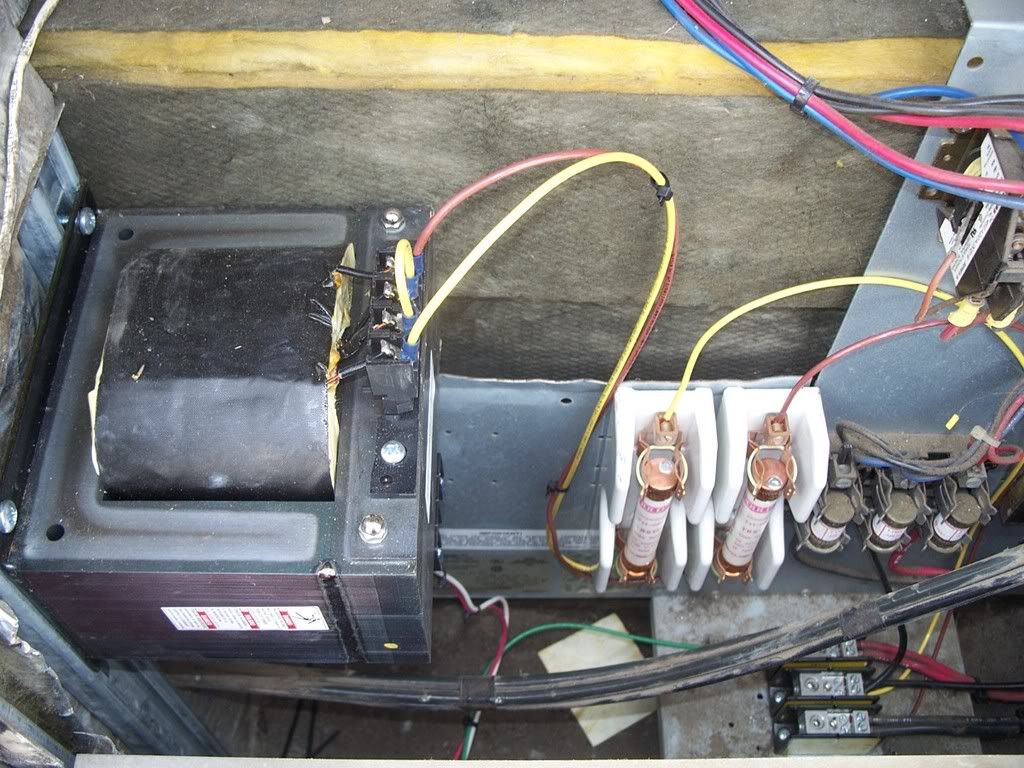

    Here's a glimpse into a unit that I have. No 120v for a few hundred yards and no water for a few hundred yards. Fortunately there is no VD on water.
    I had an electician mount a permanent trans and a GFI outlet on the unit.
