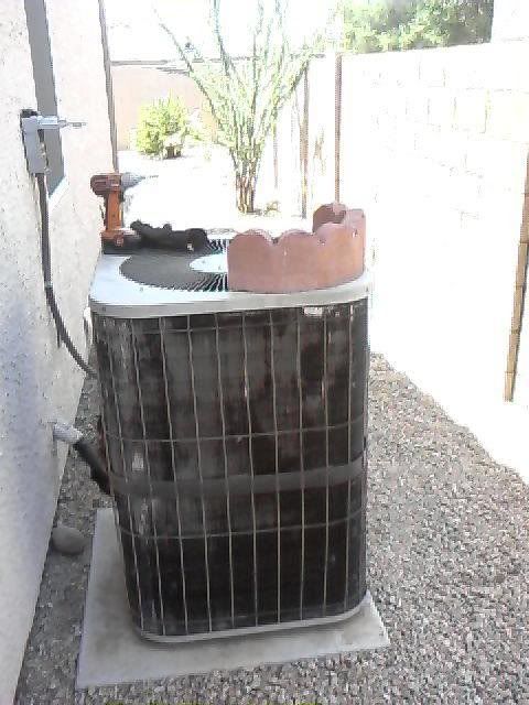

    Today my bro in law emailed me this picture. The company he works for does mixed commercial and residential so he still finds these gems.
    Oh THIS brings back memories...
    This was a common sight in Goodman Country.
    Heavy bricks used by the home owners to quiet down these rattling TURDS so that they could sleep at night!
    I can't count how many of them fan blades I had to bend and balance by hand so the home owner could sleep. I was really good at it.

    Nice Picture
    The drill is worth more than the condensor.
    Indeed!

    Those were marketed as really QUIET!
    But for some reason, the harmonics between the compressor and ODM made some weird noises.
    I would cut think pieces of iso pad into home made "rybber washers" and put them under the feet to the ODM fan grill and run the screws through it to stop that noise.
    This was one of the first Goodman Silencer Systems that I witnessed.
    If you removed the heavy rock, it rattled like a mo fo!
    The fan blades were so thin, a bird dropping would bend the blade and make it vibrate the entire unit!
    I got quit good at balancing the blades by hand to make them as quiet as possible. And there was NO USE in buying a new blade fomr Goodman. The distributors didn't keep the blades in a box, they were either hanging on the wall or in a pile on the warehoue floor. Many new blades were as bad or WORSE than the one you are replacing. So from then on I just fixed the old one.

    I thought that was a crown on the first picture.
    Arizona
    5,482
    Quote Originally Posted by troyorr View Post
    LOL! While there are a few Goodman lovers that may grace a TURD with a crown... this was actually a High Tech Goodman Vibration Dampner.
    A common accessory to Goodman Desert Series units in Phoneix, AZ.

    I saw one of those last week on a Goodman package unit!
    As soon as I saw it, I knew what it was there for!
