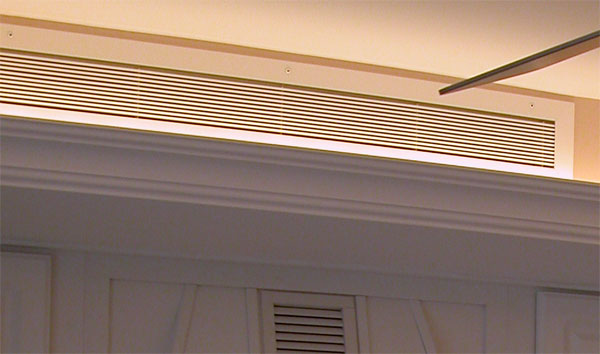

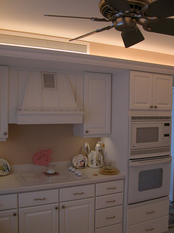

    Case in point, the kitchen at my other condo. By the calcs, I needed 196 sq in of vent surface area to cover the room quietly. It's a 35 year old high-rise building, so low ceilings (7-8') and solid-pour concrete walls/ceilings means everything has to be run in soffits. Good luck trying to fit a 14"x14" vent in there. So, this was my solution:
    Closeup:
    That vent's only 4" tall, 36" long. There's a smaller one at the other end of the kitchen (4"x12"). They deliver the CFM needed, quietly and discretely. At the same time they added a pleasant visual element and somewhat of an optical illusion. The length of the long vent makes the eye think the room is longer than it really is. And yes, linear bar grilles are more commonly found in "freaking office buildings." I think they look far better than what is normally installed in residential construction.
    These vents actually became a godsend. The balcony has been glassed in, which invariably meant I want to cool it. At the same time I didn't want to build large soffits through existing rooms to run ductwork. Instead, we used these vents with a 15 degree deflection, aimed at the ceiling. We used a similar, but larger crown moulding to what's pictured here around the windows as a deflector. In essence, we created an air curtain. Even with the windows open, the air curtain does an excellent job of keeping heat & humidity outside.

    The register in the kitchen looks very very nice...never even seen ones like those.
    I was only kinda freaking about bigger ducts and butt ugly huge square vents like you see in some office building.
    That would like...bring down the value of my condo somewhat, in my opinion.
    Bigger or...another duct would ease the overly healthy air flow I have.
    I just don't want a huge register grate above my couch...that might look freakish.
    Thanks for the pics. What kinda of registers do you have in your LR...living area?

    Linear bar grilles throughout the house, with one exception, a tiny 6"x6" two-direction ceiling diffuser in the guest bath which had 7' ceilings. Wasn't about to build a soffit in there. Even that diffuser's considered to be a "commercial" diffuser. I don't remember the exact model #'s off the top of my head, but the linear bars are from Titus HVAC, CT-series. The ones pictured and installed are the "pencil proof" spacing, done for purely aesthetic reasons (trying to make a 35 year old condo appear modern). Going with this spacing forced us to use a larger vent because the increased spacing = less free flowing air. The 6"x6" would be a TDC-xxx. You might think the TDC is a "butt ugly square" diffuser, but at this small of a size, it looks quite nice and sits flush to the ceiling.
    I'd suggest you browse their offerings: http://www.titus-hvac.com. They have an extensive collection of performance data listed including noise criterion (NC) data. Their extensive performance data's why I keep spec'ing out their products. I know without a shadow of a doubt how the systems are going to perform before the first component is ordered. There's other manufacturers out there as well.
    I will caution you 'though, commercial HVAC diffusers, especially linear bars, aren't cheap. Expect a bit of sticker shock if it's the first time you've priced them out. That said, they can actually enhance the aesthetics of the room if done right. Case in point (wish I could take credit for this one):
    Curved Linear slot diffusers along the bottom edge, curved linear bar grilles on the side-wall of the curve.
    The next time you're in a better office building, hotel, or retail space, take a look to the ceiling and upper walls and see what people have installed. Just because it's a "commercial" product doesn't mean you can't install it in residential. There's commercial recessed lights & a commercial lighting control system in my home as well. Ended up going with the commercial stuff when I couldn't find what I wanted on the resi side of things.
