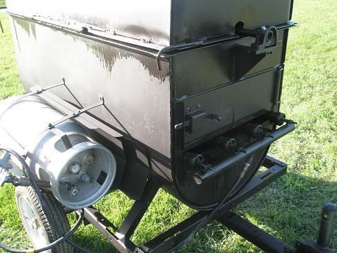

    mine is about 75% done, so far I have spent close to $500 on it, here some pictures.
    thats the motor and speed reducer, hopefully it be done in another month, I just dont have the time.

    Wow! Do you think you have enough burner capacity in that??? Looks like a mircowave for pigs. Ya got to cook them slow to allow for beer drinking, ya know.

    I'm going to paint it when done, I bought a gallon of rustoleum high heat paint for that purpose.
    the burners should be OK , I can have all four fired at 400K btus or fire just one or two for slow cooking, its going to look alot nicer when finished, work starting to slow down I'm hoping to take sometime off before the heating seasson and finish it up.

    I finished the hog roaster over the weekend, I lowered the burners and made an opening above to light them up, I got the tank up to 500F and blasted the inside with vegetables oil and let it burn for another hour, now I have to find a pig the give it a try.
    13,856
    Looks pretty neat.
    The next thing you have to engineer is how to secure the pig to the shaft.
    When that pig starts to cook it will want to fall apart. After trial and error we came up with a 2 part basket that we made with 1/2" re-bar. First we wrapped the pig in aluminum foil. Then in chicken wire.
    It ain't no fun having a half cooked pig floping around when you have a bunch of folks standing around watching you.

    when you have a chance take some pictures of the basket and post them here, I like to make something similar out of a of stainless steel rods.
    foil and chicken wire sounds like a good idea I been to a few roasts and always the meat ends up all over the place, thanks for your imput.
    Hey Guys,
    I'm new to the forum and found this site during an internet search for building a grille from a 250 gallon oil tank. We are building a grille mainly to be used for roasting turkeys at Thanksgiving for a community dinner but also on ocasion for family cookouts (large family). We had borrowed a grille that was set up on a 250 gallon tank (run off propane) and it worked really well. The borrowed grill had (1) burner that was made out of 1 1/2" (I think) gas pipe and we plan to do the same. This burner had "slots" cut in it. However, the guy with the borrowed grille moved south and we lost contact with the grille and him. So now we are building our own. I was wondering what you used for the burners (materials list, ect)? Need to have this one ready to go for this Thanksgiving so any help would be greatly appreciated!
