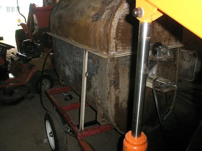

    I' almost done building one, I used two tanks cut them with sawzall, junked the tops and cleaned the bottoms with some purple degreaser I bought from harbor freight most of the oil came out after a good wash then I threw some 2X4 inside and let it burn slow over night, wash them again, the oil smell was gone, I'm making a hog roaster with gas burners and electric rotisserei, I ll post some pictures when done

    mine is about 75% done, so far I have spent close to $500 on it, here some pictures.

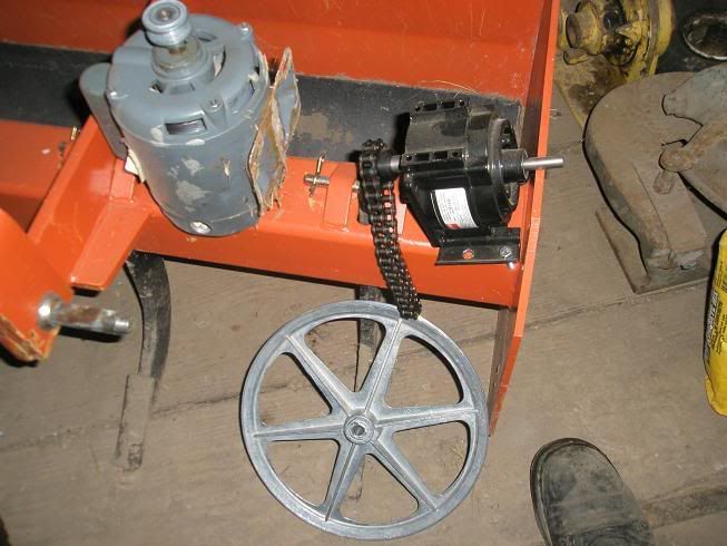

    thats the motor and speed reducer, hopefully it be done in another month, I just dont have the time.

    I'm building a motorized gas fired pig roaster, similar unit made of stainless cost between $2000 to $6000, let me know where I can buy one for $500, I even pay you $100 for the info.

    Do you put a pan in that thing cause the burner seems really close to the shaft. I have seen similar units but never really looked close at the innards. I think its a cool project. I once built a smoke house as big as an outhouse. That thing worked great. I made many pounds of jerkey and sausage.
