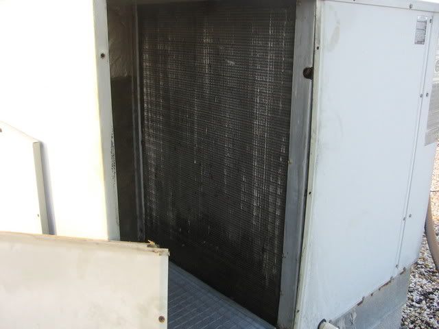

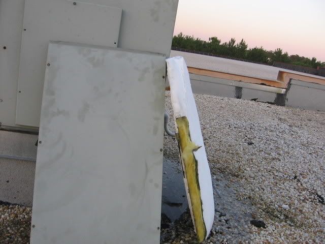

    Out on a no-cool call late Saturday afternoon. walked into the store and it was a bit warm, around 85 or so. I go up on the roof and I find this in 3 of the 4 units up there.
    After I got the ice removed I found what was going on to cause this sno-cone machine to start up.
    And it gets better!

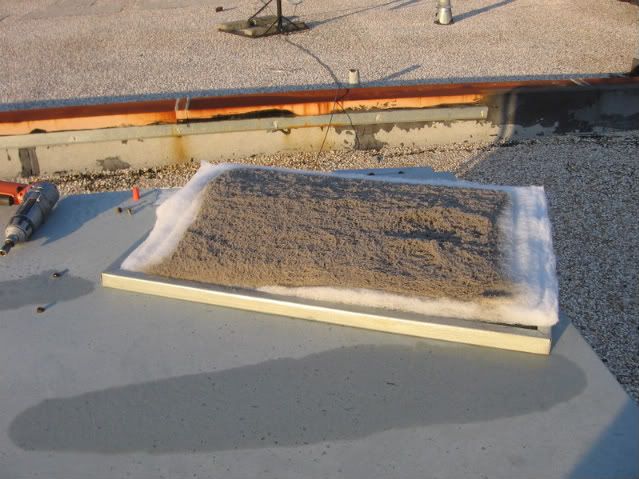

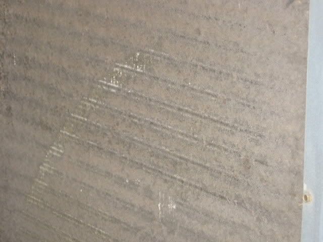

    I get the wire brush out and do some scrubbin', you shoulda seen the pile of fur I took off of the three coils. Should have gotten a picture of THAT pile, sorry. Anyway, it looks a little better now.
    I did some checking on all 4 units up there and 2 of them have lost refrigerant somewhere, all 4 need a SERIOUS evap coil cleaning and one of them has a dead LightStat but, all 4 really need new LightStats.
    We don't do any type of PM service for this retailer, all they do is wait for a catastrophic failure and call us all hot and bothered. Someone does come around every so often and change filters but, that's all they do, nothing else.

    I don't know yet if the additional work has been accepted, I just faxed it to the office that night and have to wait for the corporate clowns and bean counters to decide if they want to come off of the scratch to make these things right, as best as one can. The filters are supposed to be changed monthly by the filter changing service this site contracts with. I find many of my problems occur a day or less after the filter tech was out there, at any of this chain of stores. The guy probably was in a rush and forgot this one. This place does a fair amount of business with the resultant traffic through the front door where this unit is located and, it's located along a very dirty and busy roadway.

    wow that was a nice chunk you broke off...did you take it down with you to show it off?
    South Carolina
    1,242
    Nah, I just tipped it over and let it fall to the rooftop. That thing weighed more than my toolbag. Big thud and lots of big pieces. I took a picture cause it'll last longer.
    “Two things are infinite: the universe and human stupidity; and I’m not sure about the universe.” —Albert Einstein
    11
    how did you peel that off in one piece? i never can do that..
    South Carolina
    1,242
    It was a few inches thick, which was enough to hold it together while I got my fingers behind the top edge and eased it gently out of the cabinet. Usually they only come out in small pieces, I got lucky(?) here.
