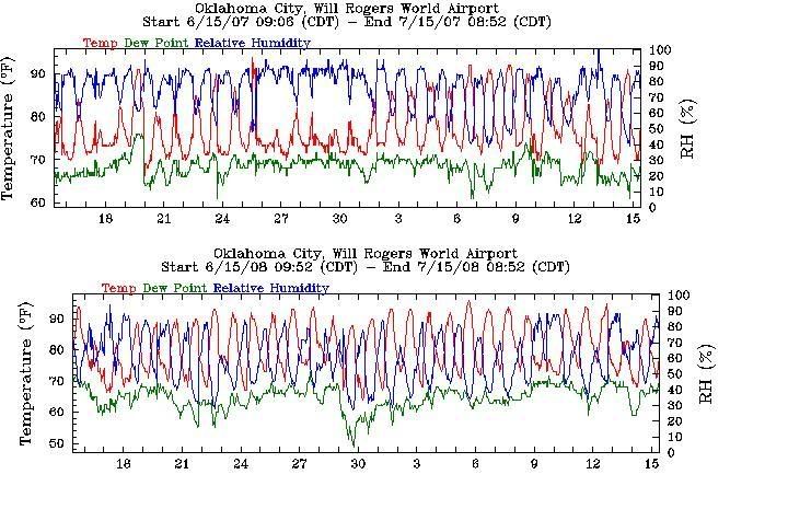

    Here's a graph of our weather for June/July 2007 and the same time 2008.
    It appears the average temp in 08 has been higher than 2007. Our house is now very comfortable and total electrical use dropped from 2800 kwh during that time in 07 to 2108 kwh in 08. Nothing else has changed as far day to day patterns, no other appliance changes, etc...
    There may be a lot of other factors to look at, but so far I am happy to have a cool and relatively dry house along with a 25% reduction in electrical use.

    I am glad to hear you are happy with the new equipment.
    We need small low cost KW meters on all air conditioning & heat pump systems, however, the weather including the humidity, wind velocity & direction, would all have to be factored in to achieve any ball-park comparisons.
    Additionally, if anything is done to reduce air infiltration, or any heat-gain, the comparison is void.
    Also IMO, the SEER Savings Charts should not be used in advertising illustrations (with the fine print added) or by contractors. Too many variables & too misleading; level up-front - with your customers. - Darrell
