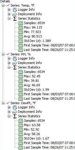

    I got a good graph here, was my attic during a time frame last August. I was not conditioning it then. We had Hurricane Dean go by in this time frame but we were only getting tropical storm force winds, steady 40 to 50 mph, some gusts into the 60s. Power was out for about 8 hours
    So over that time frame the attic averaged 80.5 F dry bulb, 46.7% RH, dewpoint of 58.3
    Attic air tmps floated from 78 to 84 F. I marked some of the temperature spikes as "1" and these all occur after the sun has set.
    I got a time frame marked as Number "2", and what I was doing here was running my AC 24/7 chilling the whole space below down to 70F. It is all concrete and I figured I would be stuck inside for a long time without power so I chilled my thermal mass down. It was fairly sunny while I was doing this, and the attic only got down around 78 degrees. The attic dewpoint was down around the minimum the stats show, and the RH plummetted up there.
    The time frame I marked as "3" was when they shut all the power down as the storm started to blow. It was obviously cloudy, the attic temperature climbed only a little bit, the RH sailed up to 50%, dewpoint rose. Pretty good considering it was like having a blower door test being run for 8 hours.
    Area marked as "4" is after the power came back on maybe 8 hours later. The humidity drops in the attic, moisture diffuses through the dry wall ceiling to the space below.
    I later added a small amount of supply air to the attic space, it averages 79 and RH in the 40s.

    Quote Originally Posted by Carnak View Post
    ... dewpoint of 58.3 ... dewpoint rose ...
    Very interesting, and very helpful. Thanks!
    How did you arrive at dewpoint - measured it directly, or calculated it from DB Temp and RH?
    If you measured it directly, what did you use? Or if you calculated it, how did you do it?

    dewpoint is a calculated value, the software that you use with the data logger calculates it
