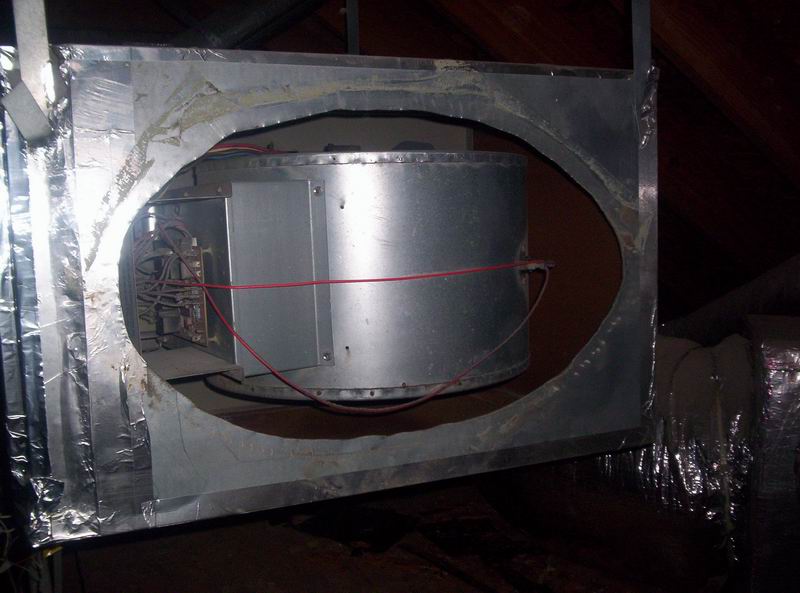

    Single 18" return duct connected directly to the bottom of the furnace.
    I wonder what size the duct effectively was with the blower assembly basically sitting in the end of the duct?

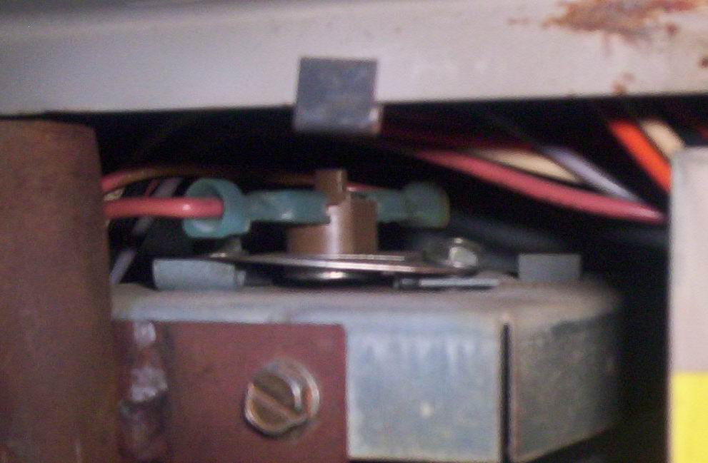

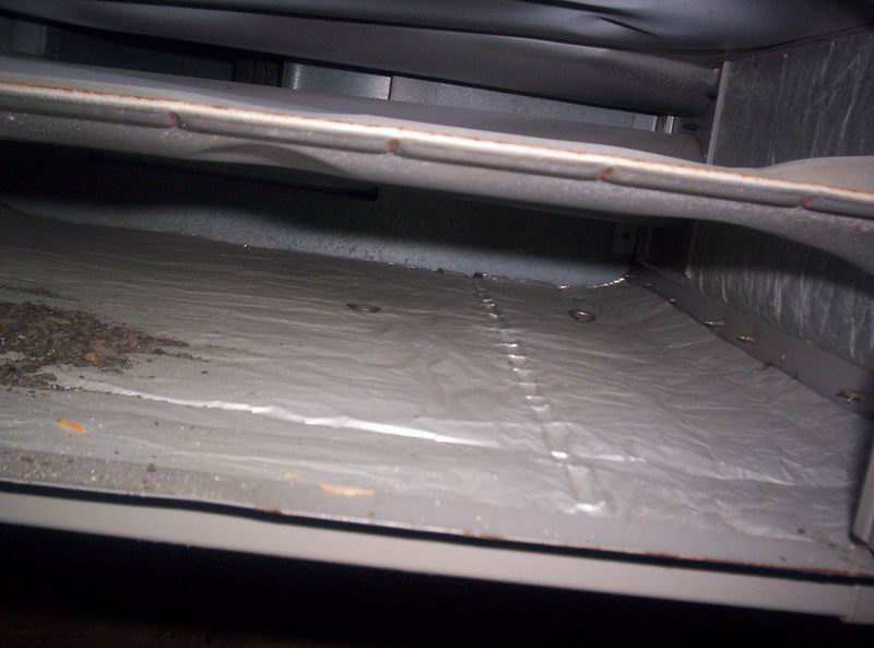

    Hmm, sooted up vent pipe on a 80% natural gas furnace, wonder what caused that?
    I guess that explains the soot...

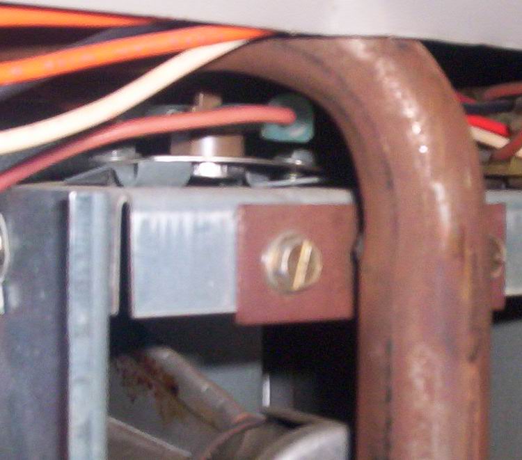

    There were 5 of them popped all the way off, at least 2 more were popped, but still hanging on like Florida ballot chads.
    Looks like their regular service outfit "fixed" the tripping rollout switch problem in the past.
    They applied the same "fix" to the other furnace in the house too!
    We were only there to replace the upstairs system, but I think we will be badk for the downstairs system real soon.

    Yeah, an Aprilaire 2200 air cleaner, return plenum, and an additional 12" return duct to the master bedroom suite.
    The 18" return duct wasn't really a big problem for the old system, the real problem was how it was connected to the furnace. There should have been a return plenum so that air was being pulled through the full size of the opening in the furnace.
    This type of installation has been the norm for many companies in my area for a long time, but I'm told some of the towns in our area are starting to fail installations that just have a duct tapped into the bottom, or side, of a furnace with no return plenum.
    14,919
    Quote Originally Posted by BigJon3475 View Post
    I'm sure something note oval and not 6" from the blower
    Hell, if it was 6" from the blower it may have been ok, lol.
    In that model of Goodman furnace, GMP075-4, the bottom of the blower assembly is less than 1" from the bottom of the furnace!

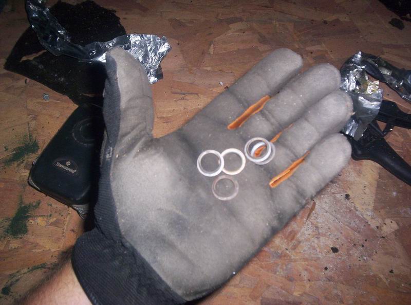

    The thousands of GMP furnaces that were installed in my area are a great for us. They have, by far, the highest HX failure rate of any 80% furnace I've ever seen.$$$$
    Oct 2006
    In a freezer or in an attic somewhere
    550
    Same here, The best indicater are those great little rings.$$$$$$
