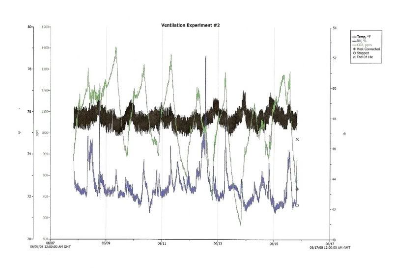

    here is my place from the evening of June 7 until now
    I have a fan forcing in just about 60 CFM when my compressor is running.
    Average Temp 74.8 black line
    Average RH 43.4% blue line
    Average CO2 1058 PPM green line
    I was keeping my home set for a constant 75F, I will increase the ventilation rate some more, as I would like to keep CO2 spikes under 1200 PPM, plus I do not enjoy paying 35 cents a kWh, so I will be raising my set point up.
    Humidity spiked up over 50 when the cleaning lady was in ironing clothes and mopping all the floors.
    I think I will be able to pound in about 100 CFM of fresh air and hold under 50%.

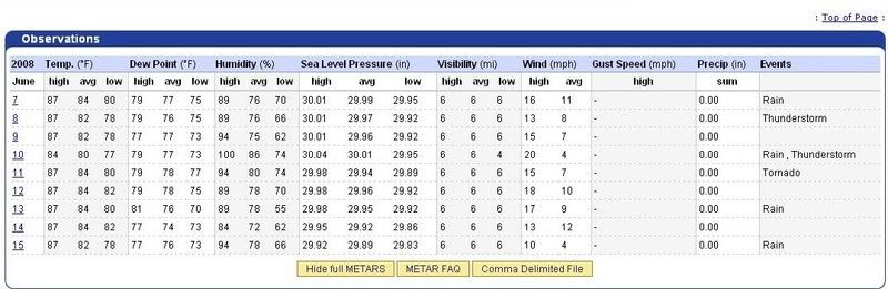

    Weather summary over same time period
    I got 5000 gallons of rain water in my cistern right now. Dewpoint averaged 77F or the time period.
    We had some water spouts again

    If you look at the humidity/dewpoint in the ambient air here, you can see that infiltration is not an issue, I am running about 520 CFM per ton
    I drop that blower speed to low and I will be holding under 40%

    your averaging about a 69 dewpoint over the same time period
    http://www.wunderground.com/history/...q_statename=NA
    let it be for a few days and see how you do, give it a chance to do its job
