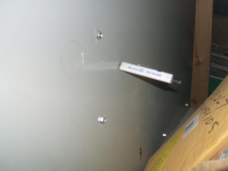

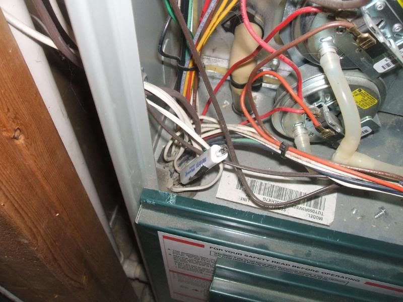

    Here are pics of the holes I am talking about. I have a pocket screwdriver stuck in them for reference. As you can see my furnace is much closer to the wall than yours is and I got my hand back there to get the screwdriver in, so your installer should not have any issues.
    before blower/after filter
    after blower/secondary heat exchanger, before acoil
    You can't fix stupid

    right, on either side of the blower, of course the secondary is in there also, but would be hard pressed to measure between the blower and the secondary without some major creativity.

    From your picture "178" it looks like you are suggesting that he take a measurement with the upper panel removed. Am I interpreting that correctly?
