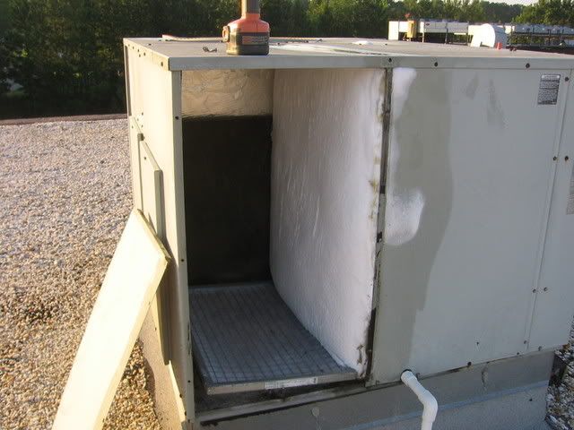

    So how did you get off that ice in one chunk again? I would of had to pull out the buckets of water/torch for that one, the ice around the coil is also the hardest and stuck deep in the fins. I don't get how you could just walk up to the unit and pull off that chunk of ice unless this was a heat pump or had a hot gas bypass?

    Actually, after the remaining libation(beer) passed through my system, I remembered that these are actually heat pumps. I had put that one into heat and kept pulling at the slab until it worked loose from the fins The ice inside the coil area melted first allowing me to extricate that massive chunk of ice. I just eased it on out of there, propped it up and took some pictures.

    Isn't that a small 1" thick washable air filter I spy laying over the return inlet? It looks to be only about 14x25x1 and the electrostatic type!
    That thing needs to be pitched the fack off of the roof and the normal filter rack reinstalled along the evap coil.
    I would also then us the 2" pleated filters. It would provide about 6 times the surface area as that POS washable electrostatic filter laying in there!

    Payson, this particular customer contracts with some filter changing service from somewhere and whatever they contracted to use in the units is what the customer is going to get, we are not allowed to do anything with the filters except maybe shake the dust out, or rinse them if needed, and put them back in.
    The material you spy is just a fiberglass media that has, if I'm lucky and usually I'm not, an almost 10% efficiency rating, until they get clogged like you saw earlier. Actually, the media is maybe 1/2" thick, it's the frame that's 1".
