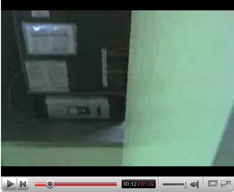

    This is a video that I never did get around to posting until today.
    This crap used to make me mad. It would take what? 5 to 10 minutes for the installers to move it a little as they were installing the new furnace and everything would have been fine. But heck no! It was BLOW-N-GO time in SCW!
    I used to see this kind of crap all too often from this company.
    Quality Control? WHAT Quality Control??? It was a joke. Because even if they sent one of us to do a Quality Control. They never fixed the problems we found.

    I sell the American Standard version of that filter – AccuClean.
    The filter has three parts – the prefilter, the ionizing plate (I don’t remember the technical term) and the collection plates.
    In the video the tech removed the pre-filter and the ionizing plate. The ionizing plate is not supposed to be removed.
    Regardless, forcing the customer to bend a reusable filter is inexcusable.

    Hmm.. Trane told us that the tips needed to have the lint cleaned off on the ionizer deal. I know he said to be careful, because they are sharp, and that they bend easy.
    I was the tech recording the video.
    And we did clean LOTS of them during each PM 6 months apart.
    Them ionizer tips DID need cleaning.

    It has to be removed every year at max to clean the crap off the needles.Trane says in the lit cleaned by qualified tech the one in my house gets so dirty it looses at least 40+% efff.
    the customer is not supposed to service it

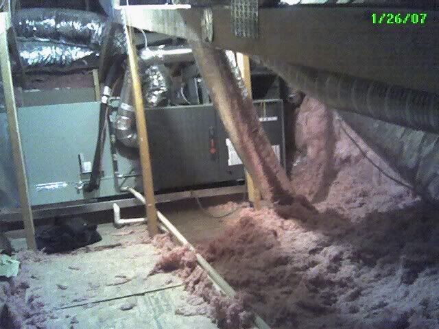

    Actually. The door needing to be removed isn't NEARLY as bad as some of the ATTICS they installed them into!
    The attics in Peoria and Glandale, AZ are very difficult to access through small 16" wide scuttles in the kids small sliding door closet.
    Then once you get up there you drudge through the insulation walking on the trusses because there is no catwalk.
    It's already bad enough. But then some wise a$$ salesman would sell a EAC on a new system with the EAC in that attic!
    By time you climb back through there to reinstall the EAC cells, it's more dirty than when you removed it for cleaning!!!
    Especially the Perfect Fit that you washed with water!!! The insulation puffing up from you climbing like a monkey sticks right to them b@stards!
    EAC in the attic = sh*tty sh*tty!!! Any salesman who sells one for an attic air handler/furnace like we have here is just an a$$hole!

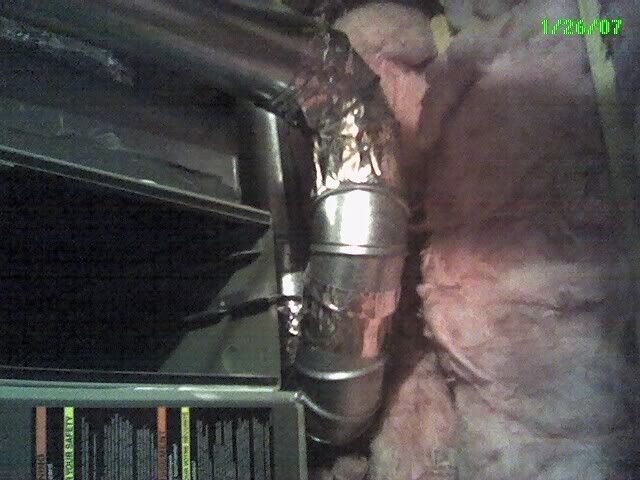

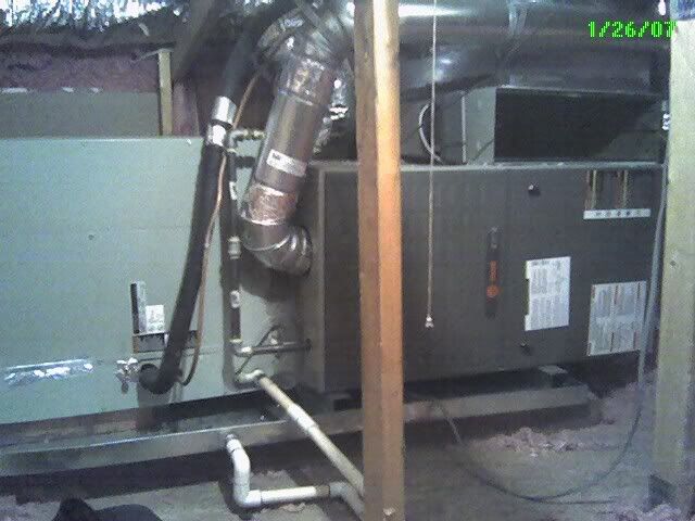

    Wait a sec... Speak of the DEVIL!
    This one had a catwalk. Try the attics with the furnace further away and NO catwalk and blown in insulation!
    And yes. The installers here routed that flue pipe up, over, back down, through a 180 that's wedged into the insulation inthe vaulted wall, and then on up to the roof!

    You are correct. In a moist climate the needles build up deposits. These deposits can easily be cleaned, but should be cleaned by a technician, not the homeowner.
    I can tell you what likely happened. The sales rep sold the job without bothering to measure the closet. The tech was told to install, and was under the gun in materials and hours, so moving the unit (plenum adaption, sheetmetal, etc) was not an option.
